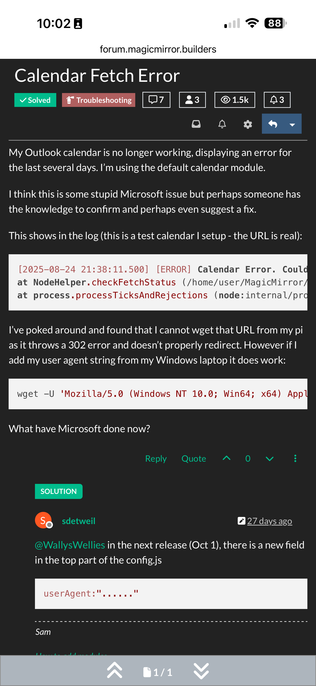

@mdbyers he used this value from post before, -U parm

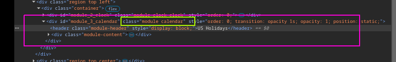

you would have to open the browser developers window to see what the problem is
ctrl-shift-i (chrome)
console tab,
put ext3 in the filter field.
