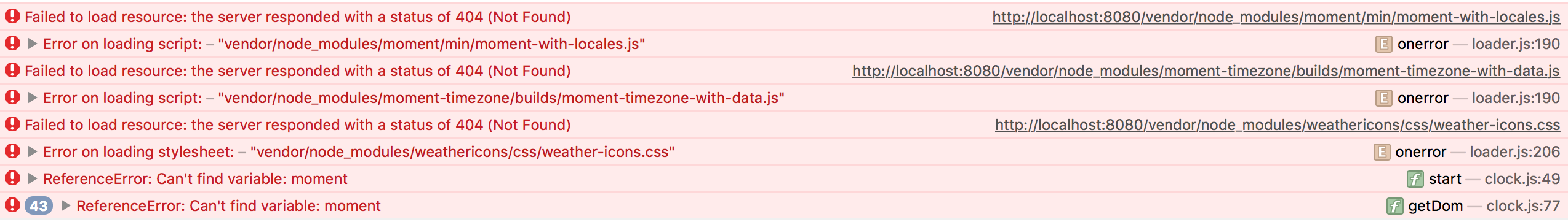

      First jump into my magic mirror project… and first surprise
      On launch, the javascript console alerts me that some files are missing in vendor subfolders. However they just do not exist.
      Did I miss something during the installation or do I have some extra action to do to fix it ?

        Can you post the console output here?
          Here it is - and I confirm that those files do not exist in the folder

            Ok, my bad, I meant the terminal output. I’m sorry about that. Many times the terminal output will tell us where the problem lies.
            So, run the mirror then quit the mirror. Then post your terminal output in a code block because this old man can’t see those pictures very well :-/
