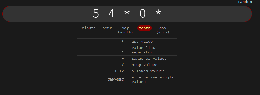

      I’m just saying that’s not what crontab.guru says:
      it makes it confusing.

      In my log I get this message :
      [2025-02-01 09:42:27.196] [LOG]   MMM-ModuleScheduler is scheduling MMM-EasyPix using "* * 1 1 *" and "59 23 31 1 *" with dim level undefined
      [2025-02-01 09:42:27.206] [WARN]  Month '1' is limited to '29' days.
      February has “29” days. Not January.
      So the month in my config file that I use from “https://crontab.guru/” doesn’t match what you would expect from this scheduler.
      In the documentation it say
      “Months 0-11 (Jan-Dec)”
      I have updated to use this as a key:
      Month
      1 = February
      2= March
      3 = April
      4 = May
      5 = June
      6 = July
      7 = August
      8 = September
      9 = October
      10 = November
      11 = December
      I noticed month “0” doesn’t work for January.
      Now that we are in February, it seems to be working after I set what I want to see in February as the month to be “1”
