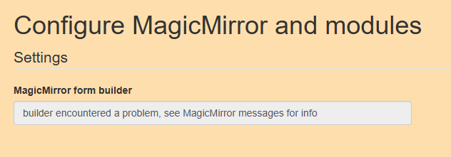

      @sdetweil Also, I am using Ubuntu Server so no GUI.
      The MMM-Config module does not work, I’m guessing because it is a docker installation and maybe permissions are a thing?
       [11.03.2025 11:44.21.236] [ERROR] (node:1) UnhandledPromiseRejectionWarning: ReferenceError: fetch is not defined
      magicmirror  |     at buildFormData (/opt/magic_mirror/modules/MMM-Config/module_installer/runserver.js:135:20)
      magicmirror  |     at module.exports (/opt/magic_mirror/modules/MMM-Config/module_installer/runserver.js:73:3)
      magicmirror  |     at Class.startit (/opt/magic_mirror/modules/MMM-Config/node_helper.js:329:5)
      magicmirror  |     at Class.setConfig (/opt/magic_mirror/modules/MMM-Config/node_helper.js:163:10)
      magicmirror  |     at Class.start (/opt/magic_mirror/modules/MMM-Config/node_helper.js:169:10)
      magicmirror  |     at /opt/magic_mirror/js/app.js:232:18
      magicmirror  |     at new Server (/opt/magic_mirror/js/server.js:93:3)
      magicmirror  |     at /opt/magic_mirror/js/app.js:226:20
      magicmirror  |     at loadNextModule (/opt/magic_mirror/js/app.js:171:5)
      magicmirror  |     at /opt/magic_mirror/js/app.js:166:6
      magicmirror  | [11.03.2025 11:44.21.236] [ERROR] (node:1) UnhandledPromiseRejectionWarning: Unhandled promise rejection. This error originated either by throwing inside of an async function without a catch block, or by rejecting a promise which was not handled with .catch(). To terminate the node process on unhandled promise rejection, use the CLI flag `--unhandled-rejections=strict` (see https://nodejs.org/api/cli.html#cli_unhandled_rejections_mode). (rejection id: 1)
      magicmirror  | [11.03.2025 11:44.21.237] [ERROR] (node:1) [DEP0018] DeprecationWarning: Unhandled promise rejections are deprecated. In the future, promise rejections that are not handled will terminate the Node.js process with a non-zero exit code.
      magicmirror  | [11.03.2025 11:44.22.054] [ERROR] stderr 2: grep: ../../js/animateCSS.js: No such file or directory
      magicmirror  | cp: cannot stat '../../js/animateCSS.js': No such file or directory
      That is from the docker compose up command.
      Then when I hit: http://ip:2222/configure I am greeted with this:

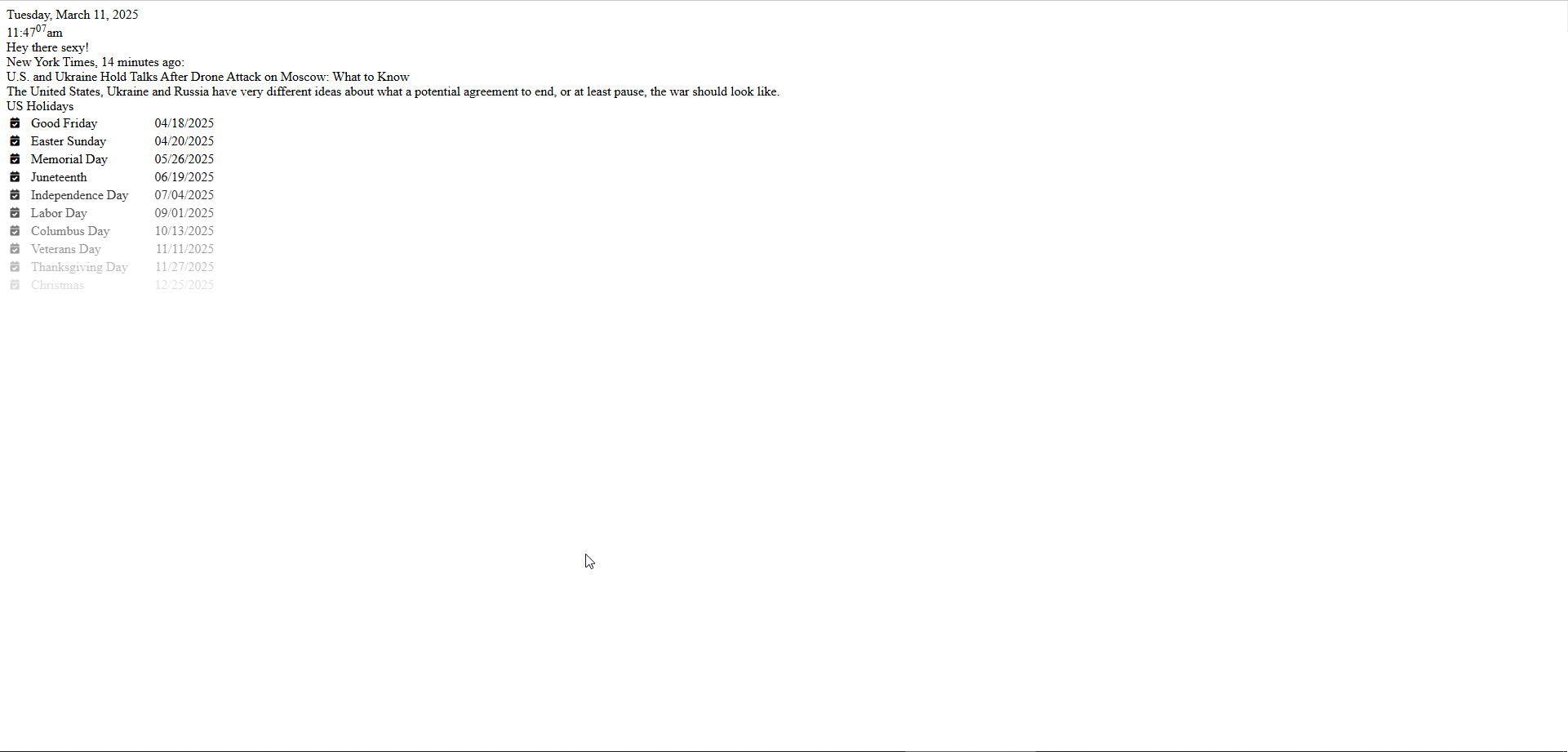

      Also to prove I’m not doing anything, crazy… I removed the custom.css file I had that I was looking at and here is what it looks like (this is what it looked like default:
      As you can see, lots of room to breathe for those modules. Here is what the config.js looks like:

      This is the config that comes with the docker-compose that I posted earlier. I’m guessing someone made this and there is issues and really I need to do a default install and try from there.

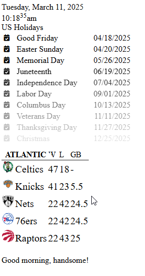

    • I'm new. Trying to understand and have a few questions....
      I’m new and open to learning, reading, whatever. I have my basic install up and running, no bubbles, no troubles:
      I tried to add some module I found that had like a sports standing thing. It says it should be on the “top right” according to the config.js file. Here is what it looks like:
      If that is the top right, yea… and it is smushed.
      I then added a calendar piece and tried to configure it. I then followed someone who made a CSS for the calendar component to change the CSS to make it look more like dakboard and well… I’m not sending a screenshot of that lol.
      So I guess where do I begin? Why does the thing not seem to be full screen? What can I do to change that? Next would be the “regions” or “areas” like “top right” and as the one with the calendar I was following said “bottom third” things like that. Where does that come from? How come my stuff is so squished like the sports team ticker piece? Some of the stuff on the docs page either just doesn’t exist or isn’t correct. For example it states “customCss - The path of the custom.css stylesheet. The default is css/custom.css” I went there, there is nothing in there.
      I see all these amazing setups on the forum like this one: https://forum.magicmirror.builders/topic/19169/dakboard-esque-layout
      And there is some stuff below. I’m not sure where that would go. Is that a main /css/custom.css file? I see settings for modules that seem to define them from one central location.
      Any help or pointing me to where I can get some starter stuff that starts out from say a basic “I just loaded up the docker container, let’s start configuring” would be amazing.
      Thank you.
      posted in Forum
