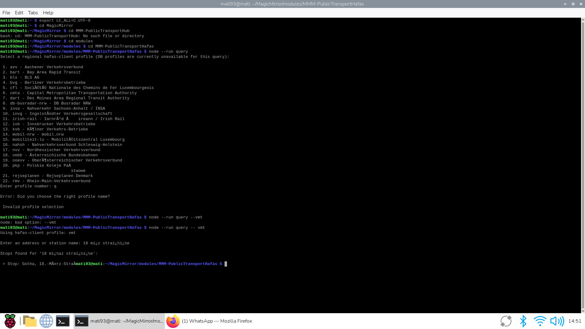

              Your module does not support German keyboard special signs. How can I find 18 März Straße and besides is not working for Gotha Hbf.
              What’s going on with world transport APIs lol
              Module is working on main station but it’s very hard to find stationId from the German streets like 18 März Straße Gotha. Any ideas? Node query is limited to bigger stations.
                What makes you say that? It works for me.
                Did you check the vmt profile?
                This seems to be what you are searching for:
                      module: "MMM-PublicTransportHafas",
                      position: "bottom_left",
                        hafasProfile: "vmt",
                        stationID: "167050",
                        stationName: "Gotha, 18.-März-Straße"

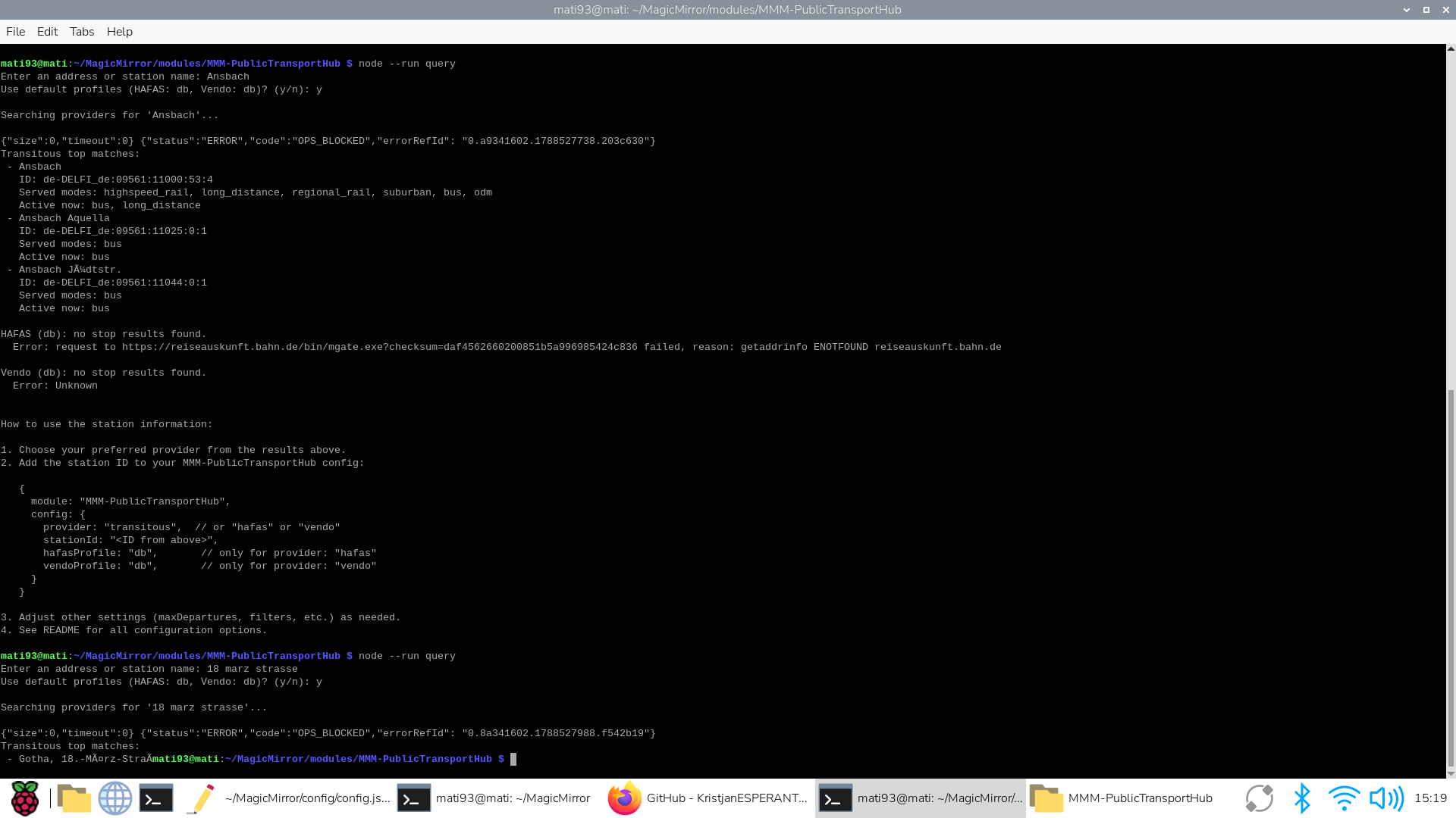

                    Error code ops_blocked when searching in MMM-PublicTransportHub module using node --run query

                      @Mati_93 Have you managed to figure it out yet? :) If not, please describe again what you’re trying to do and what’s not working. And most importantly, which module you’re using.

                        @KristjanESPERANTO well, on the HAFAS (older module) I see only 22 position when I am searching using node. Why? How to change pagination.
                        Your new Module HUB is working for Gotha Hauptbahnhof… perfectly. I want to use both modules if possible.
                        And still on theolder module HAFAS is update socket issue 1
                        On the searching mode inside node query can not use German letters. How to configure node CLI?20260904_14h51m33s_grim.png
                        On your module Hub node console looks exactly:

                          So ID searching tool from node query still won’t work with 18 März Straße but i found stationId via gemini :) (i dont’ like it). In my code i am using two TransportHub modules (TransportHafas is in code but i am not using in my carousel because is not working) . 18 Marz Strasse station does not return an error but says that there is no departures. Ansbach station works perfecly.

                            @Mati_93 Wow, that a bunch of separate issues. These three minimal configurations work for me with the Gotha stop. Please test them one at a time first. I had to play with timeInFutureMinutes a bit to get departures.
                            MMM-PublicTransportHub with HAFAS
                              module: "MMM-PublicTransportHub",
                              header: "Gotha, 18.-März-Straße",
                                provider: "hafas",
                                stationId: "167050",
                                timeInFutureMinutes: 720
                            Older MMM-PublicTransportHafas
                                timeInFuture: 720
                            MMM-PublicTransportHub with Transitous
                              position: "top_center",
                                provider: "transitous",
                                stationId: "de-DELFI_de:16067:167050::16705000",
                                contact: "@Mati_93",
                            Please note that vmt is a HAFAS profile, not a provider. Therefore the Hub needs provider: "hafas" together with hafasProfile: "vmt".
                            The garbled German characters look like a UTF-8/locale problem on Raspberry Pi OS. Please check:
                            locale
                            locale charmap
                            The result should contain UTF-8. You can configure this with:
                            sudo raspi-config
                            I think you have to select Localization Options → Locale and enable de_DE.UTF-8 UTF-8. Log in again or reboot afterwards.
                            As a quick test, you can search without special characters:
                            18 Maerz Strasse Gotha
                            OPS_BLOCKED usually comes from a blocked DB endpoint. For Gotha, please use the regional vmt profile instead of a DB profile.
