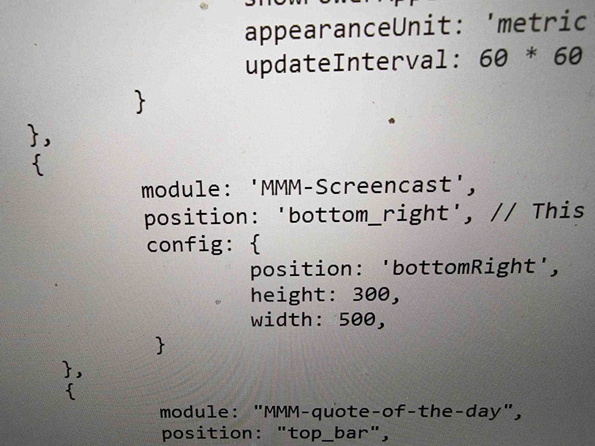

                      • J Offline
                        jste84 @JerryP
                        JerryPJ 2 Replies Last reply Reply Quote 0
                        • JerryPJ Offline
                          JerryP @jste84
                          @jste84 Please use the code input</> button
                          and copy past your code
                          what I now see is u missing de cast name
                          F 1 Reply Last reply Reply Quote 0
