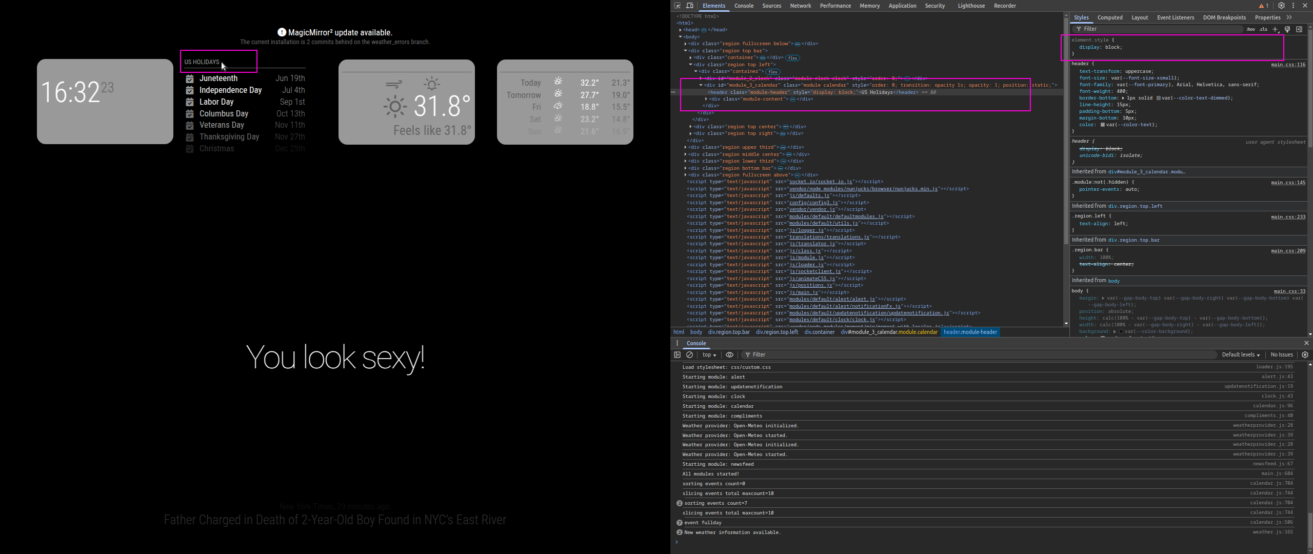

                                sdetweil @plainbroke
                                @plainbroke
                                im not quite sure I understand
                                using the sample config
                                I used the arrow, to navigate to the header… (pointer in left pink box)
                                it opened the html page to that element (middle pink box, you can see the class=module-header)
                                you can test the styles in the top right pink box
                                if you have something that updates frequently, (clock tick on 1 second)
                                you can temp disable second (displaySeconds:false in clock config) hit f5 to refresh that page the it won’t update except on minute (as an example)
                                plainbrokeP 1 Reply Last reply Reply Quote 0
                                    @plainbroke said in MMM-CountUP (COVID19 example):
                                    .CountUp
                                    module name is MMM-CountUp
                                      @plainbroke you can see the module name in the html too, in green box
                                      css has to match
                                      . means class=
                                      # means id=
                                      no prefix means html element, table, p, img, div, span …
                                      stuff to the left of the { is the selector clause
                                      it ‘selects’ the elements the styles between the {} apply to
