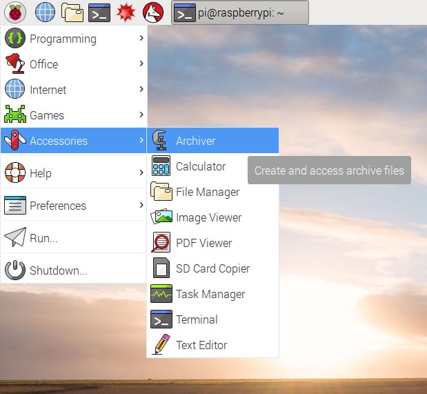

                            @kurt I’m not in front of my RasPi at the moment and can’t give you exact instructions, doing it from memory. Hitting Ctrl Alt F1 will drop you into terminal session, hitting Ctrl Alt F7 (if I’m not mistaken) will take you back to X window session. You can try switching to different sessions by hitting Ctrl Alt F1, Ctrl Alt F2 etc. until you get to the right place.
                            If you are running full Jessie with PIXEL there is also a terminal app in GUI that you can use. Some more info on PIXEL is here
                            PIXEL Menu
                            :point_up: see that Terminal Icon? That way you don’t have to switch back and forth.
                            If you are running Jessie Lite you can hit Windows Key + R (sorry I’m not really sure what the correct terminology for Windows Key on your keyboard) and type lxterminal
