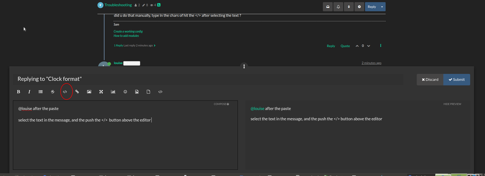

            sdetweil @louise
            @louise and what do you have in the clock config?

                        @louise after the paste
                        select the text in the message, and the push the </> button above the editor
                        L 1 Reply Last reply Reply Quote 0
                        • L Offline
                          louise @sdetweil
                          @sdetweil OH, that’s what you meant by block.
