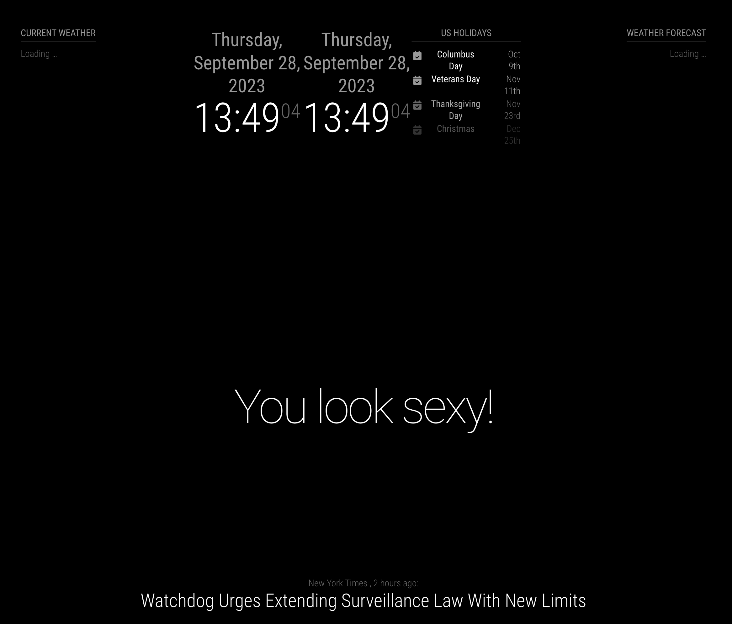

            .region.top.center .container .module {
              float: left;
              max-width: 32%;
            and I put 3 modules (2 clocks, 1 calendar) in top_center region.
