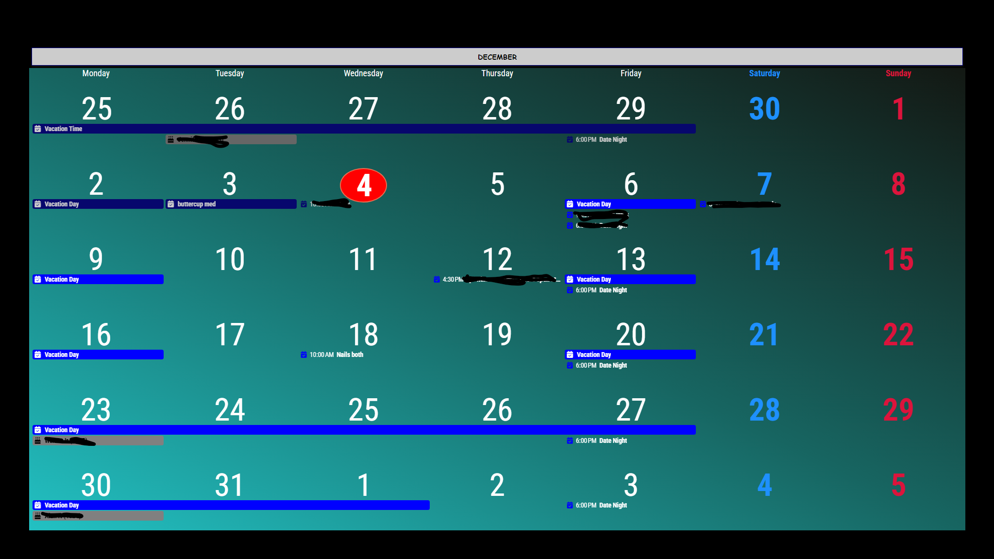

      I am a MM Newbie, and I’ve been working for a couple weeks on a family calendar based on MM. I would like the layout to look something like the image below with large numbers and the current date circled in red. Is that the type of customization I would do using a custom.css?

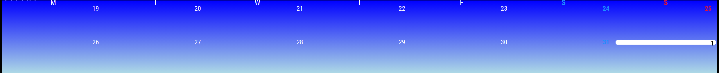

                        @NotMyCircus
                        as an example with css changes I did this in about 20 minutes
                        config
                                module: "MMM-CalendarExt3",
                                position: "middle_center",
                                  mode: "week",
                                  weeksInView:2,
                                  firstDayOfWeek: "1",
                                  fontSize:'30px',
                                  headerWeekDayOptions: {
                                    weekday: 'narrow'  // this makes the weekday 1 characater wide
                        css
                        .CX3 .cw {
                        	display: none !important;
                        .CX3.bodice {
                            background:linear-gradient( blue,lightblue);
                        .CX3 .cell {
                        	background: transparent;
                        	border: transparent;
                        .CX3 .cell.today {
                        .CX3 .cellDate  {
                          margin-right: 20px;
                        .CX3  .cellHeader .cellDate span.dateParts.month.seq_0  {
