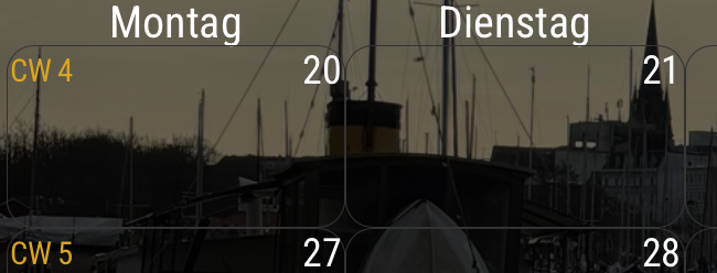

        for the radius update the css and add a border-radius in .CX3 .cell:
        .CX3 .cell {
          border: 1px solid var(--celllinecolor);
          background-color: var(--cellbgcolor);
          height: calc(
            var(--cellheaderheight) + var(--cellfooterheight) +
              calc(var(--eventheight) * var(--maxeventlines))
          position: relative;
          border-radius: 25px; /*adjust as you like it*/
        But it might look strange if it is too big. This radius is valid for every calendar cell of course. I use it, too with 3px only.
        Result with 25px:

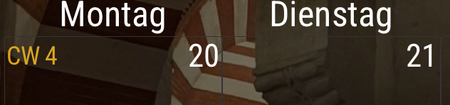

        For the other issue I’m also searching for a solution. You can see it my picture :)
        I had this idea:
        CX3 .week {
          width: 100%;
          padding: 0 5px;
          margin-top: 5px; /*this helps but is stupid in the next week*/
          height: calc(
          position: relative;
        Regards, Chris.

          I’ve found it!
          .CX3 .weekGrid {
            display: grid;
            width: 100%;
            grid-template-columns: repeat(7, [cell-start] 1fr [cell-end]);
            grid-auto-columns: 0fr;
            margin-top: 5px; /* ADD THIS*/
          Regards, Chris.
          B 1 Reply Last reply Reply Quote 1
