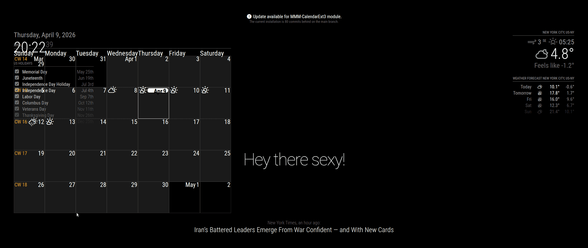

            hey guys, i cant seem to figure out how to resize this module, i have tried the css, custom cssa and even modifying the module bottom.left css max size. how can i double the width?!2c853f08-d988-4582-a4de-4037442666bd-image.jpeg thank you

                            @megagprime try this
                            module
                            position:"bottom_left",
                            no custom.css setting

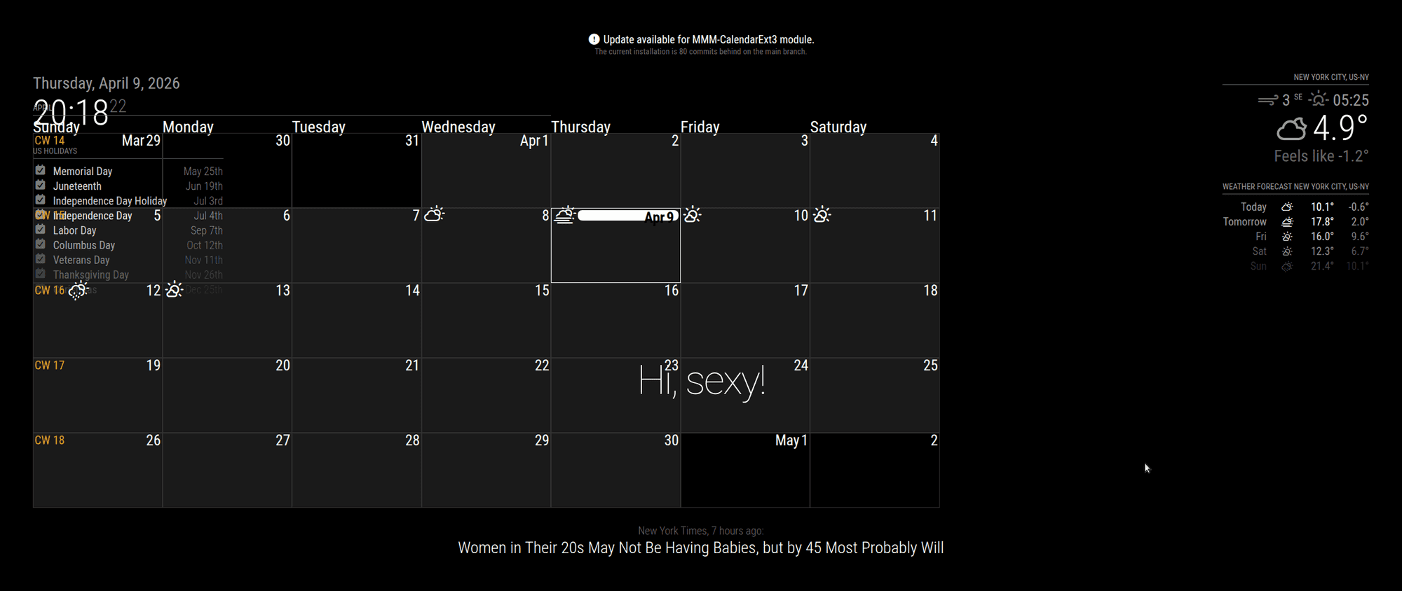

                            .MMM-CalendarExt3 .module-content {
                                width:175%;
                            adjust % as you need
