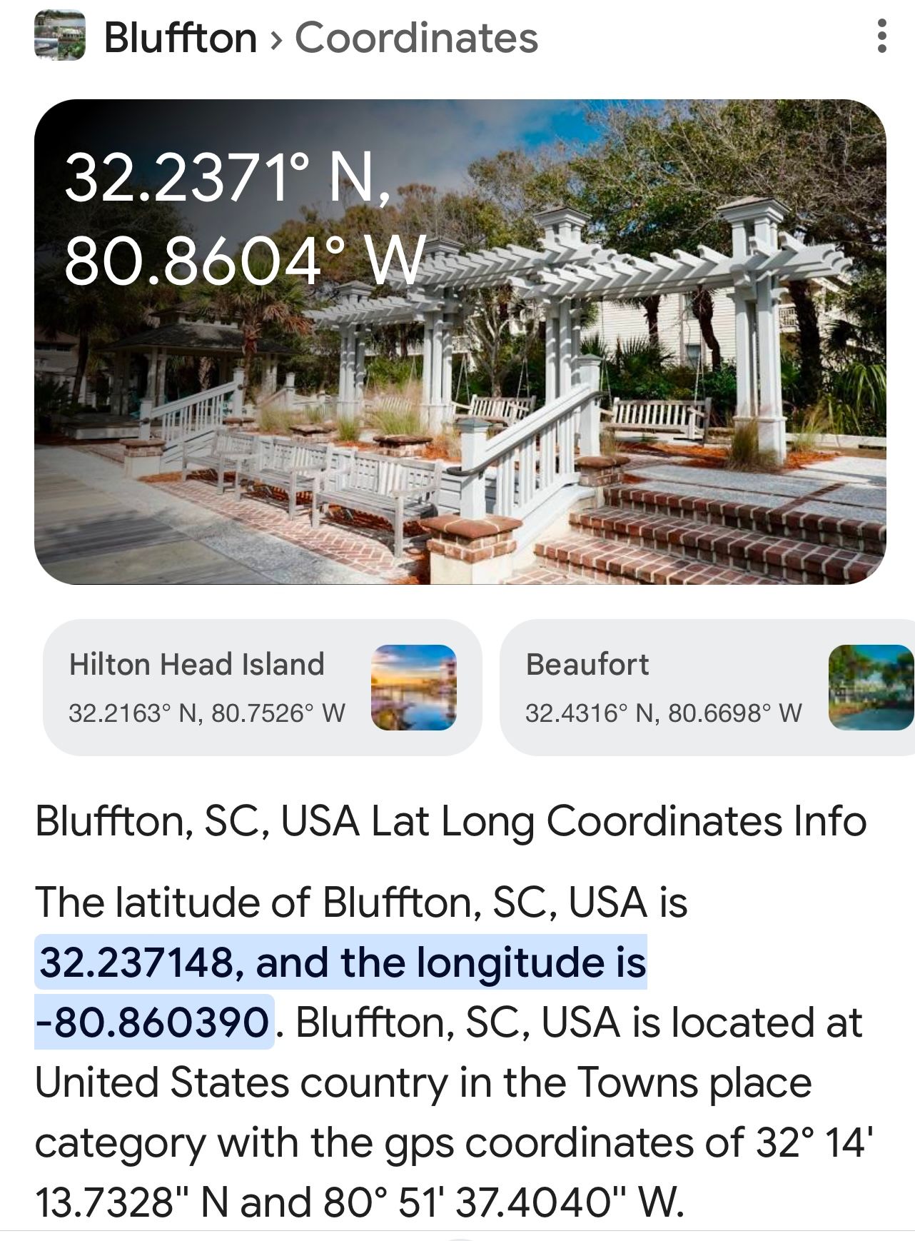

              sdetweil @atl944
              @atl944 lat/lon for Bluffton, SC
              the lat/lon in in the sample is ny central park
