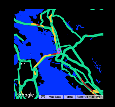

 @chrisfr1976 - I have been using Google Maps since 3 weeks and I noticed that the maps doesnt get updated with traffic unless I zoom out or zoom in. It is displaying the maps with traffic the last time I zoomed out or zoomed in. I dont see API calls in my google profile as well. Did you notice this on your end?
 @kmanne the module should refresh the info every 15 minutes (default updateInterval setting)
 @kmanne I can check next weekend. I‘m not at home at the moment. .
 @sdetweil - Correct. But it is not updating the maps unless I zoom out or zoom in. I tried adding the refresh of 15 mins in the module, but still the same issue.
 @kmanne
 I’ve just updated the code to a more robust solution with more log entry. Usegit pullin the MMM-GoogleMapsTraffic-module folder.
 Check if it works for you. Check the console logs of any issues.
