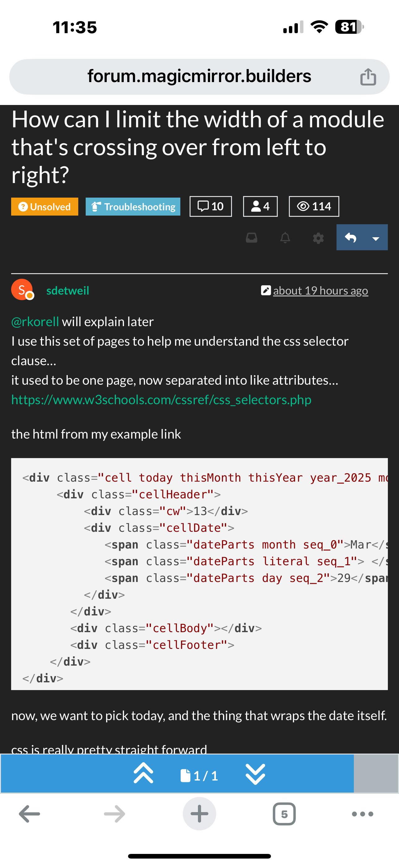

                      the html from my example link
                      <div class="cell today thisMonth thisYear year_2025 month_3 date_29 weekday_6 weekend weekend_1" data-date="1743231600000" data-events="1" data-has-events="true" id="1743231600000_1743306263377" data-popoverble="true">
                           <div class="cellHeader">
                               <div class="cw">13</div>
                               <div class="cellDate">
                                  <span class="dateParts month seq_0">Mar</span>
                                  <span class="dateParts literal seq_1"> </span>
                                  <span class="dateParts day seq_2">29</span>
                               </div>
                             </div>
                             <div class="cellBody"></div>
                             <div class="cellFooter">
                          </div>
                      </div>
                      now, we want to pick today, and the thing that wraps the date itself.
                      css is really pretty straight forward
                      left to right match the elements from the selector
                      . means class=
                      # means id=
                      otherwise its an element name (div, table, p, span …)
                      so. we want JUST content in the `CX3` class content
                         and then we want the things under `today`
                      we don’t HAVE to specify the element as long as there are not different elements with the same class… (div and span)
                      so
                      .CX3 .today
                      the space between means ‘also’, with no space it means ‘AND’ (same element has BOTH specified)
                      we REALLY want the cellDate class elements, can we get there from today?
                      yes,
                      the cellHeader element doesn’t matter, cause there is no OTHER location for cellDate, except under cellHeader…
                      so if we combine those
                      .CX3 .today .cellDate, together they define a specific element family we can ‘select’
                      we could add div.today (a div AND .today specified) , but it wouldn’t be more specific. In a calendar month there will only be ONE element with today class AND it only has ONE child element with cellDate, they are not the SAME element, so we need spaces between the selector elements
                      css will ALWAYS pick ALL elements that match, across the entire document(page)
                      so if we said .CX3 .cellDate we would adjust ALL of them, oops. NOT JUST for the one for today
                      we could use .cellDate
