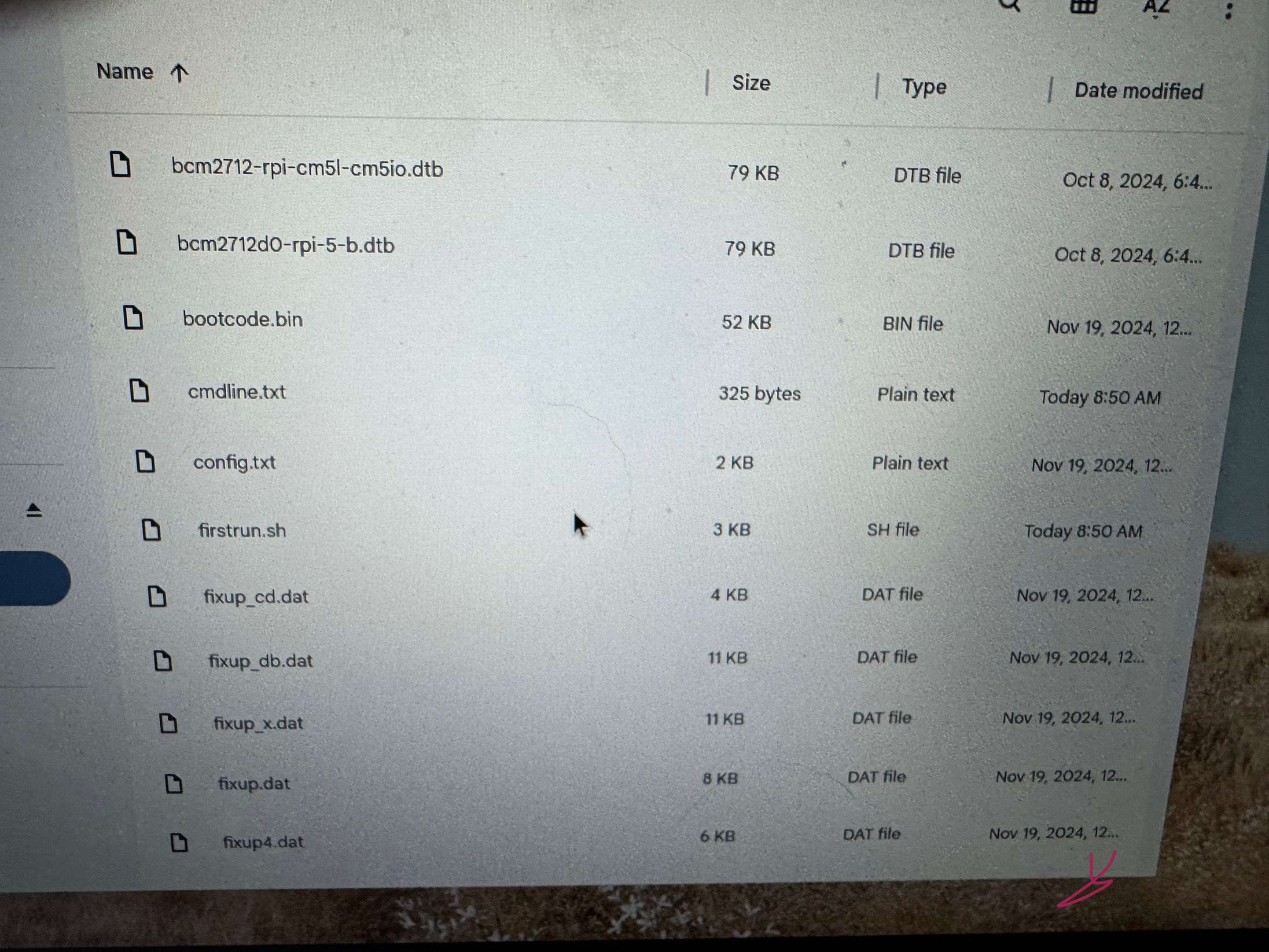

@karsten13 nope, right after flash, those files are not there.
the firstrun and cmdline.txt have todays date, I am showing hidden files (if any) -
