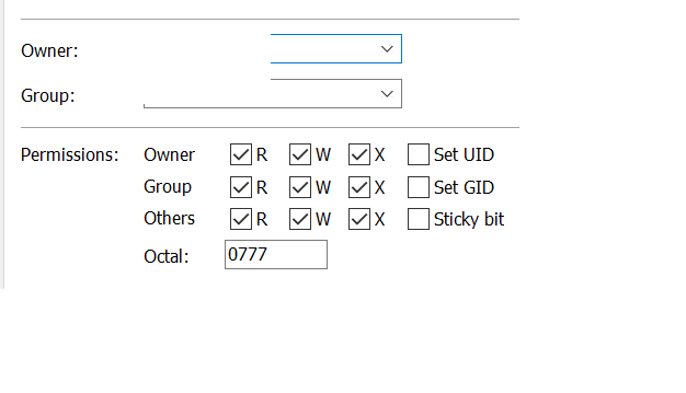

                  Sam 0 @Sam 0
                  I thought it was right but now the rights on the sh files are set to 0777 and also on the folders
                  I also did a test to see if I could execute the sh files, this works tonight the cron should execute it, let me know if it works
                    sdetweil @Sam 0
                    @Sam-0 yes. although you dont need write permission, (except for user)
                    means anyone else could change the script
