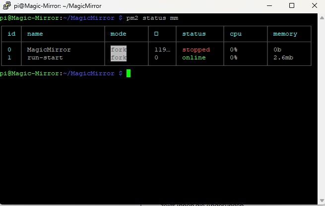

          Ich habe diese Dateien jetzt umbenannt.
          git pull ausgeführt.
          reboot
          Nun startet MM nicht mehr.
          S R 2 Replies Last reply Reply Quote 0

                                      sdetweil @chris47803
                                      @chris47803 i am away from my computer, and mobile translate is being troublesome
                                      this is why my upgrade script is two steps, made exactly for your situation
                                      it would have told you about buster and later about changes you would lose WITHOUT breaking your system
                                      now you have lost the changes you don’t remember, and got to a spot where it doesnt run anymore
