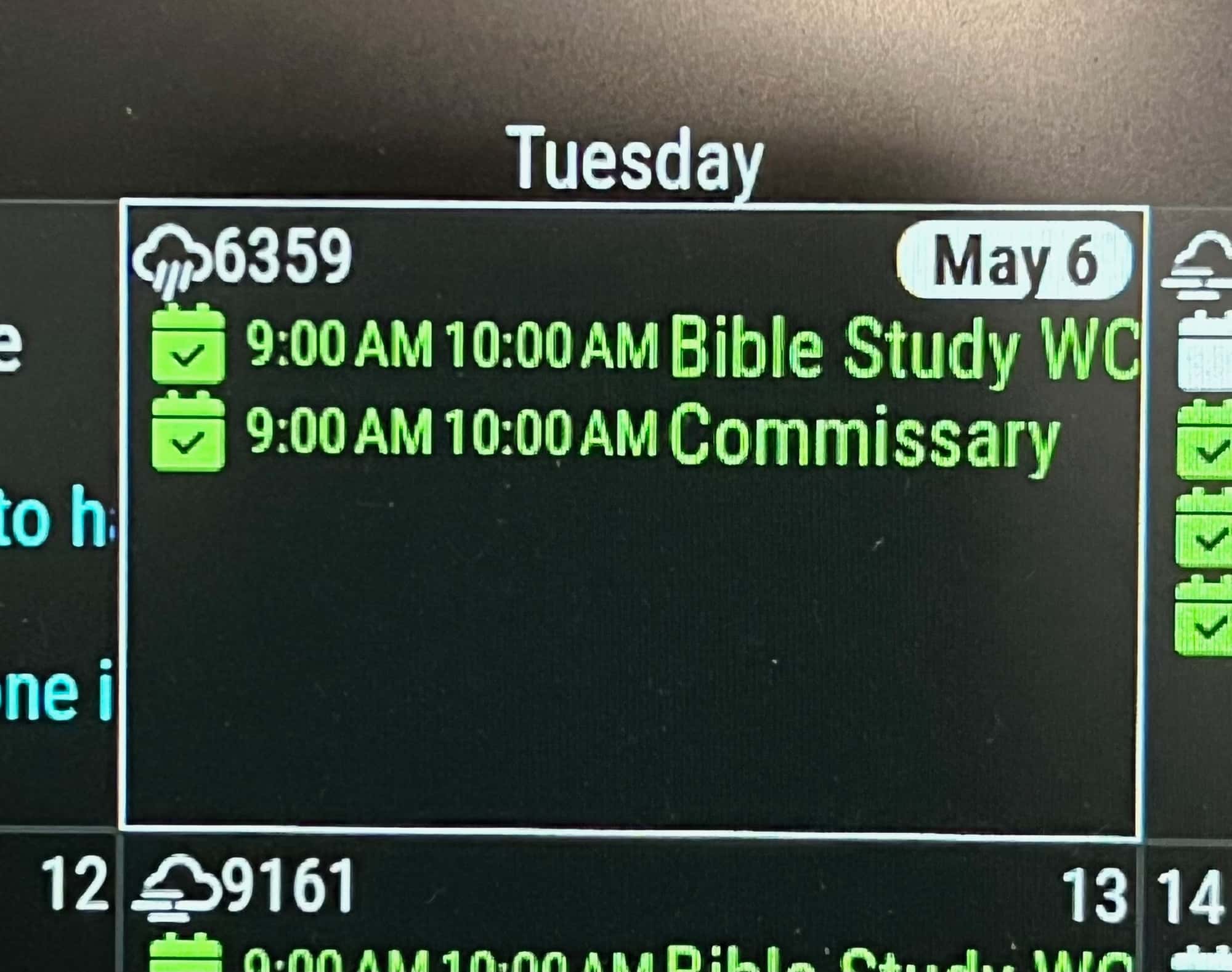

      EngrAg81
      I recently installed MMM-CalendarExt3. It currently shows both the start and end time of each event. Is there a way to stop displaying the end time? None of the pictures I saw online show an end time. I would appreciate any help.

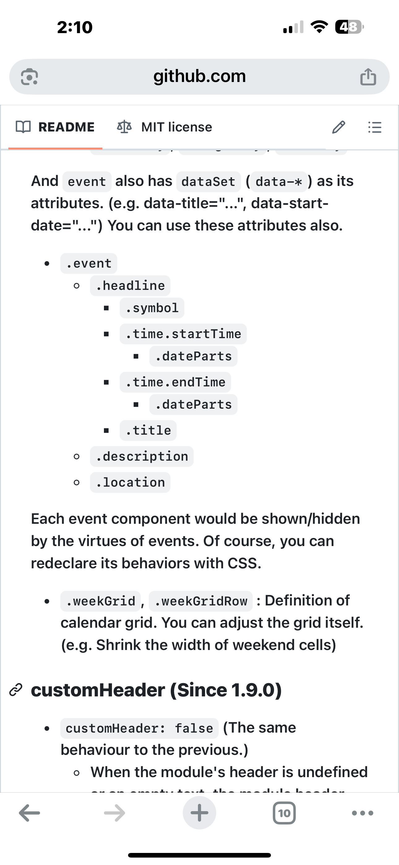

          sdetweil @EngrAg81
          @EngrAg81 use css
          from the doc
          in custom.css
          .CX3 .event .endTime {
             display:none;

            EngrAg81 @sdetweil
            It worked! Thanks!
            Do you know if there a reference in that doc about the weather icon and 4 digit number after it?
            S B 3 Replies Last reply
              sdetweil @EngrAg81
              @EngrAg81 i do not, its just the module read file,
              shown on the github page

                bobbylx @EngrAg81
                @EngrAg81 I don’t have a lot of info on it, I did tweak my weather info but it’s been a couple years now. The number is the High/Low forecast-ed temperature. Have to turn on the default weather module in forecast mode, then I added this to config.js under MMM-calendarext3,
                    useWeather: true,
                                            displayWeatherTemp: true,
                                                      weatherPayload:(payload) => {
                                                 if (Array.isArray(payload?.forecastArray)) {
                                                   payload.forecastArray = payload.forecastArray.map((f) => {
                                                     f.maxTemperature = Math.round(f.maxTemperature * 9 / 5 + 32)
                                                     f.minTemperature = Math.round(f.minTemperature * 9 / 5 + 32)
                                             return f
                I don’t remember what changes I made to get the degree symbol and up/down arrows. I’ll post here if I can find those changes.

                  bobbylx @EngrAg81
                  @EngrAg81 Ok, I think this is what you would edit to change the way those numbers are displayed, ie, High/low temp. This will be in the custom.css.
                  CX3 .cellHeader .cellWeather .maxTemp {
                    color: white;
                    font-weight: bold;
                    font-size: 90%;
                  .CX3 .cellHeader .cellWeather .minTemp {
                    color: darkgray;
                    font-weight: normal;
                  .CX3 .cellHeader .cellWeather .temperature {
                    display: var(--displayWeatherTemp);
                    padding-left: 5px;
                    font-size: 90%;
                  .CX3 .cellHeader .cellWeather .maxTemp::before {
                    content: " \25b2";
                  .CX3 .cellHeader .cellWeather .minTemp::before {
                    content: " \25bc";
                  .CX3 .cellHeader .cellWeather .temperature::after {
                    content: "° ";
