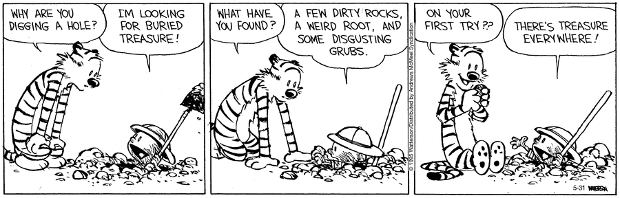

                                    plainbroke @plainbroke
                                    Hopefully you can tell it fills my screen and is todays Monday June 9 2025’s
                                    comic. We really love this comic, both my wife and I are big fans of Calvin and Hobbs comic. I really appreciate the help you provided getting the comic back to working form for us… Keep up the great work you are appreciated…
