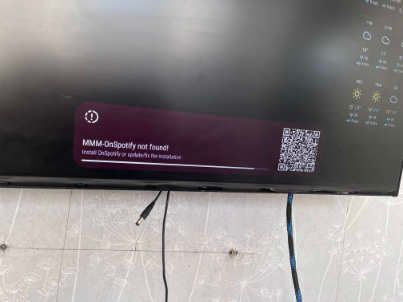

                videogame95
                Hi did you get onspotify running on your magic mirror I 'm trying get it running on my magic mirror I can only find secret client id and accsess Token but can’t find,
                refresh “Token” any help install this Module .
                I also tride to install spotify lyrics only had to add a token id .
                It looks like its trying to load on spotify that I’ve remove but not the install script
                should just try to install MMM-onspotify, Do i add all config file ?
                Any help please

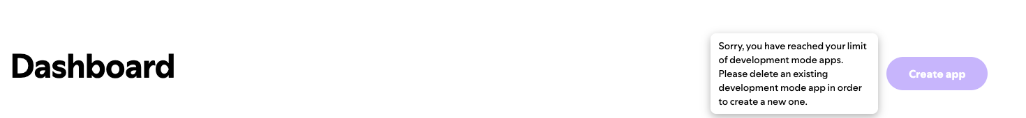

                        unfortunately when I go to the page to recreate a new app there’s no button on the page . I had deleted my old ones now I can’t make a new .
                        Do I just need wait for something to refresh?
                        any help please.
                          sdetweil @videogame95
                          @videogame95 I do not know
                          when I go there I see the button, but it is disabled as I have 3 apps defined
                            @videogame95 if you logoff and login again, does that make a difference?
                            • V Offline
                              videogame95
                              unfortunately no I just tied that I log out and back in to dashboard it came up with Spotify code box to my google mail copy code in which let me use Spotify on the web. as I said I tried login back into dashboard still no button to create an app?
                              Any suggestions
                                @videogame95 no, sorry.
                                You are on developer.spotify.com
                                Right?
