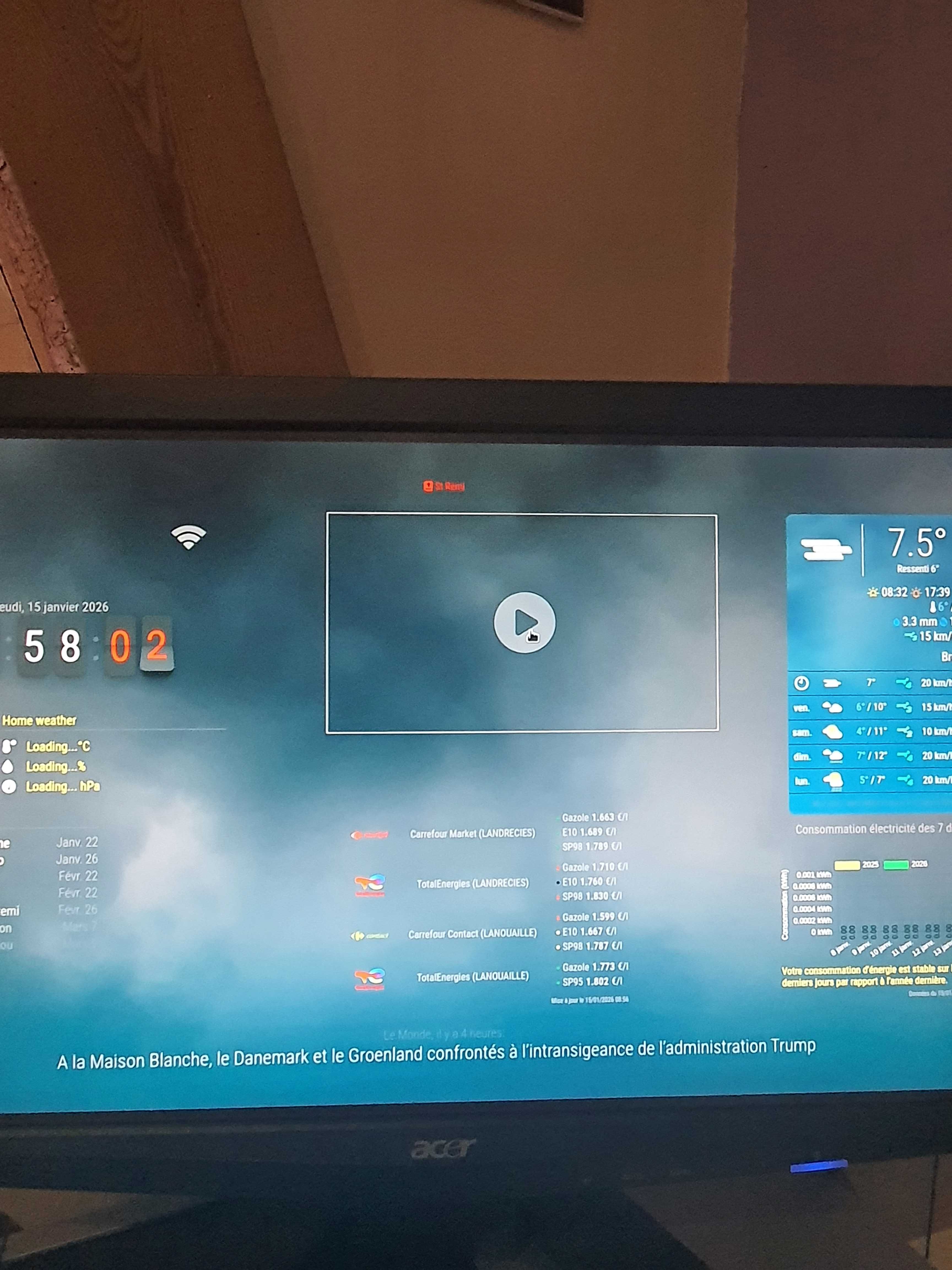

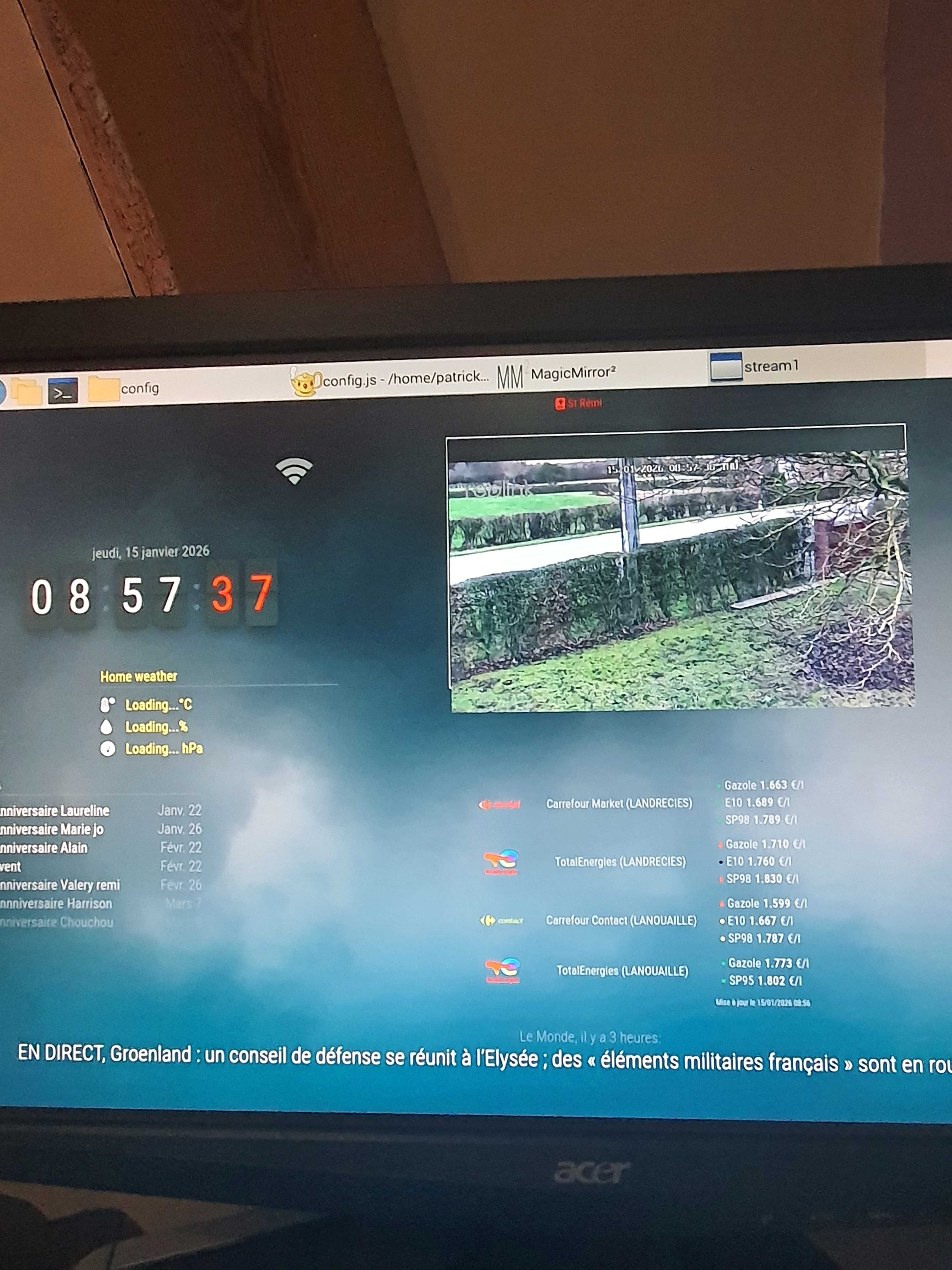

      ![text alternatif](url de l’image)Hello, I installed MMM-RTSPtream and I’m having the following problem: my camera works perfectly; I can see the video when the taskbar is present. However, once I click on Magic Mirror to go into full-screen mode, my video disappears. What should I do? Thank you.MMM-RTSP.jpg MMM-RTSPs.jpg

        KristjanESPERANTO Module Developer @pat59
        Hi @pat59,
        why doesn’t Magic Mirror start in full screen mode? Can you show me the module config?
                    @pat59 Again my question: Why doesn’t Magic Mirror start in full screen mode? I think the problem is that neither VLC nor mplayer are inline in the Electron window. They are a separate window. And when you click on the Electron window the player window gets in the background.
