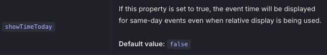

            I found this other interesting option
            but it was not better.

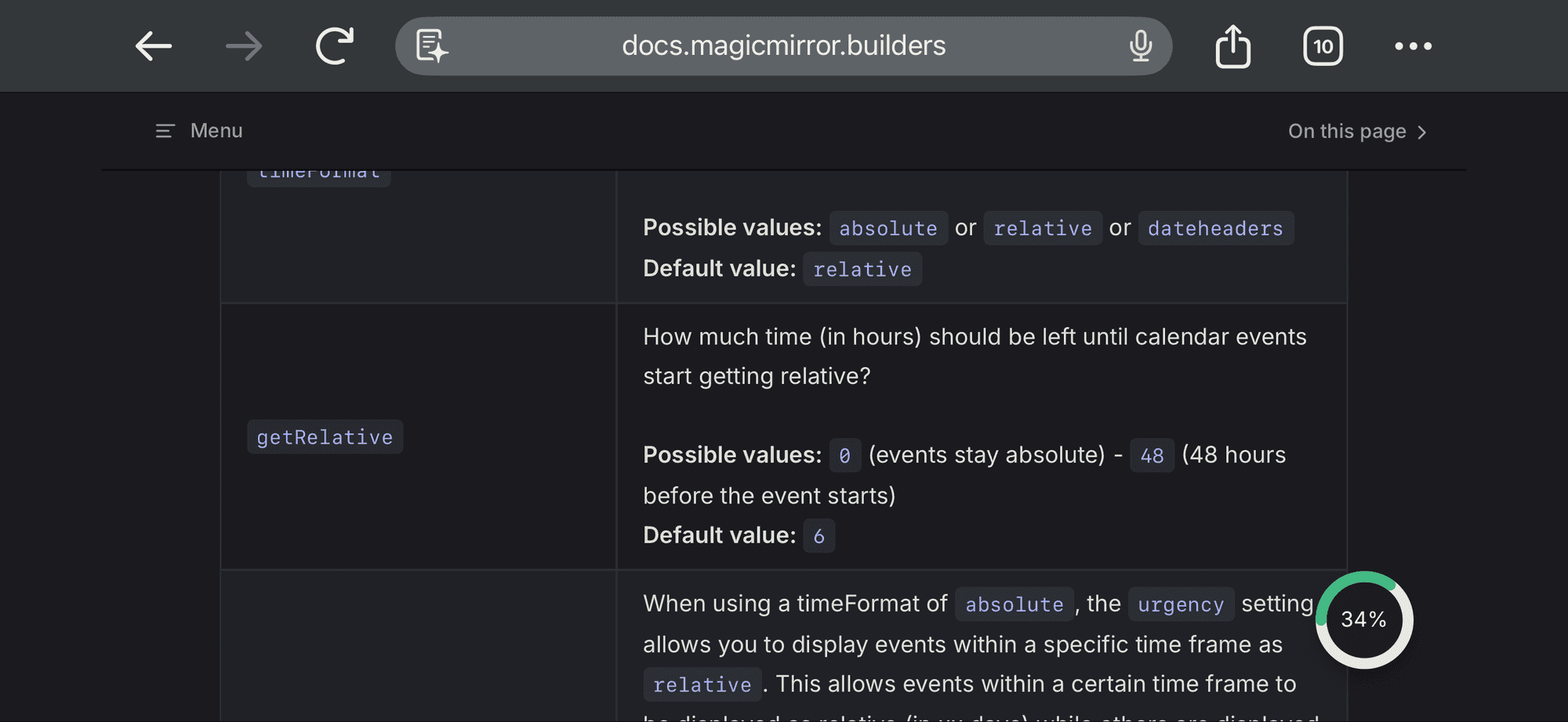

              sdetweil @com1cedric
              @com1cedric the setting is getRelative
              Should be becomeRelative or goRelative
              This is useful when an event gets close, you mostly don’t want it saying ‘today’
