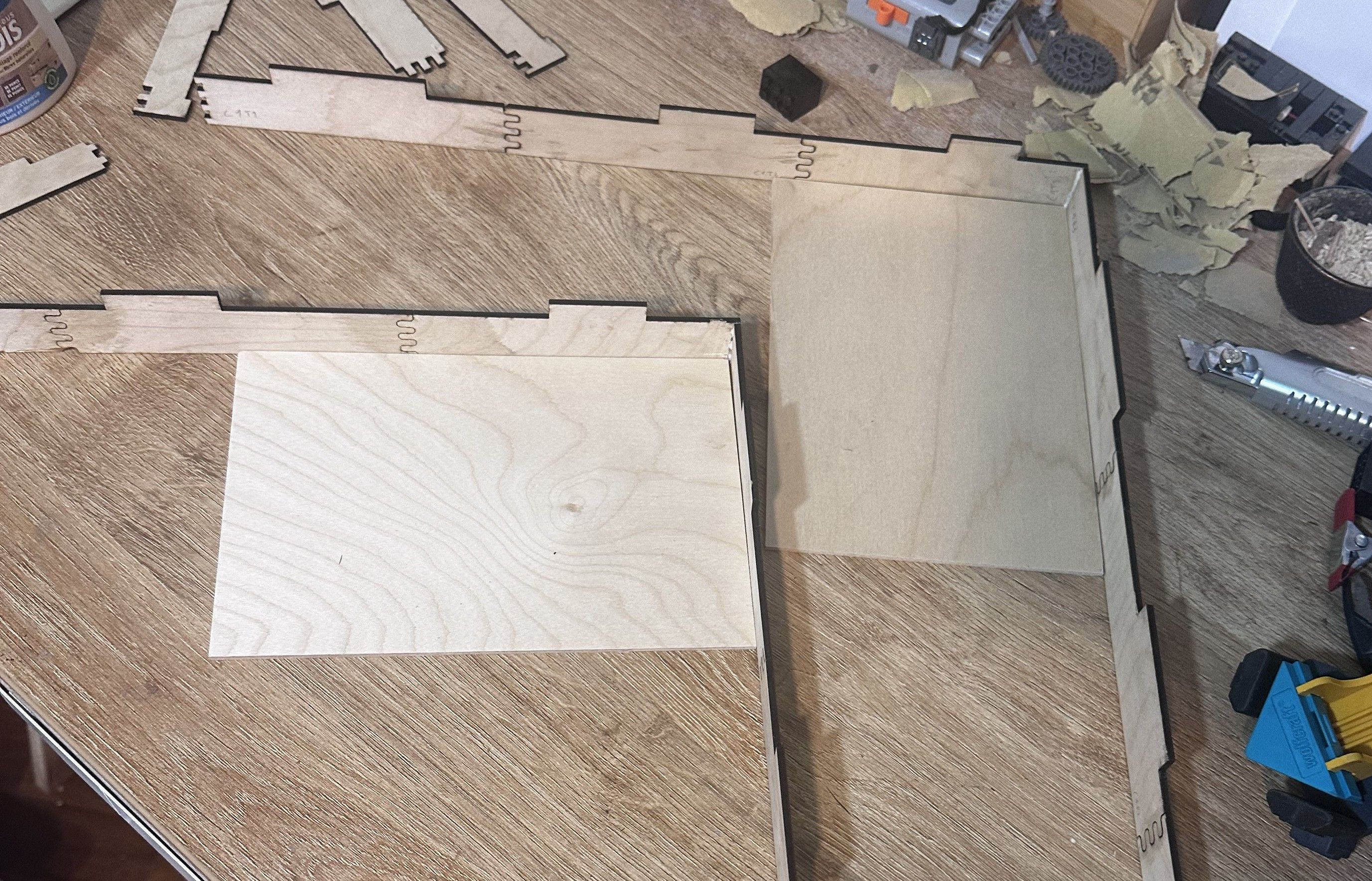

      I wanted to share a small project I just finished: a Magic Mirror with a fully laser-cut wooden frame.
      The goal was simple: instead of buying a frame, I wanted to design and cut the entire structure using a small laser cutter.
      The mirror itself is 620 × 375 mm, and the frame is made from 3 mm plywood sheets (210 × 145 mm) cut with a 10W diode laser.
      In total the frame required:
      • ~56 laser-cut parts
      • 10 cutting sheets
      • 3 mm plywood
      • finger-joint assembly
      • rabbet for the mirror
      • 2 backing layers
      For a 10W laser, cutting all the pieces for a frame this size actually worked surprisingly well. I honestly didn’t expect it to work that cleanly.

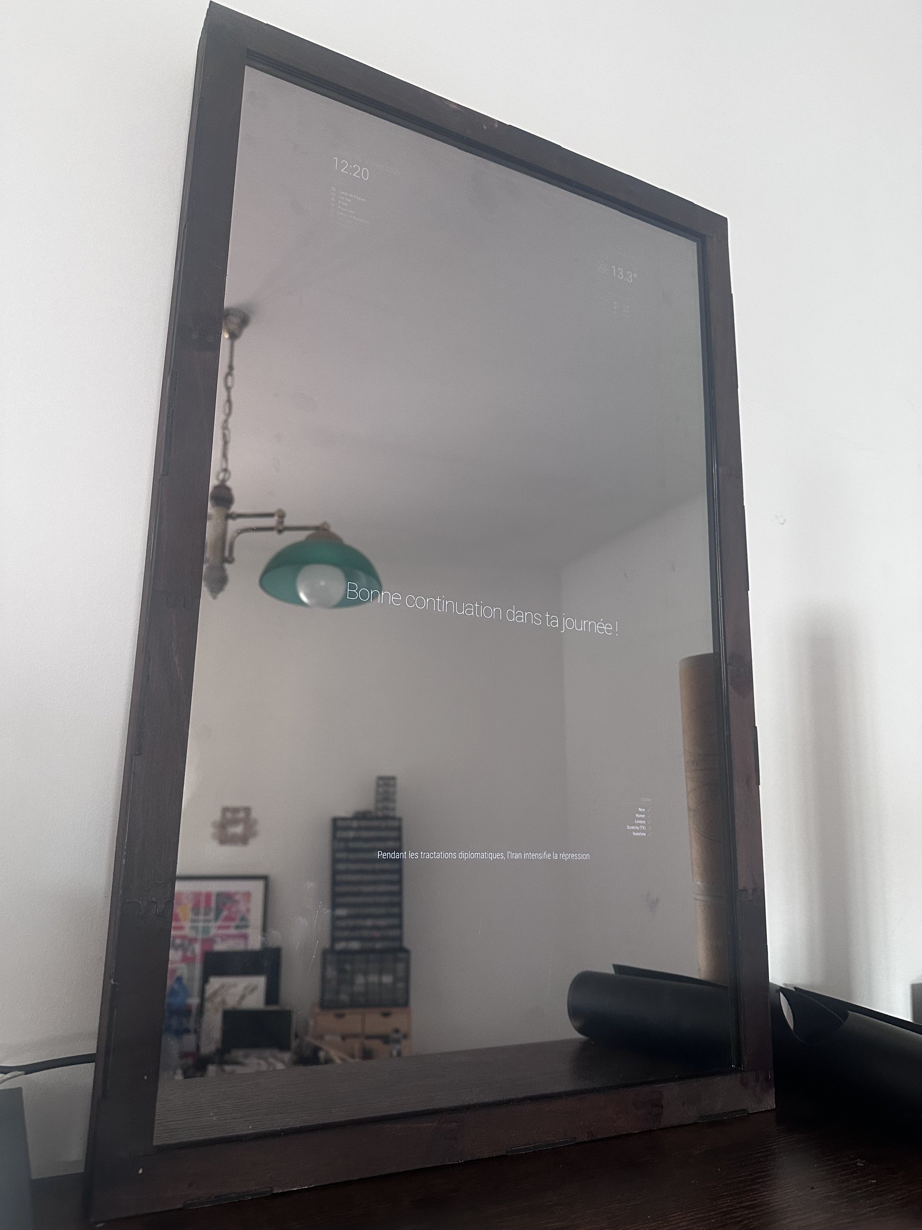

      The mirror runs on:
      • Raspberry Pi 5
      • HDMI monitor (USB pow ered)
      • standard MagicMirror modules (clock, weather, news)
      More info https://www.framistik.com/showcase
      For a first build I’m really happy with the result.
