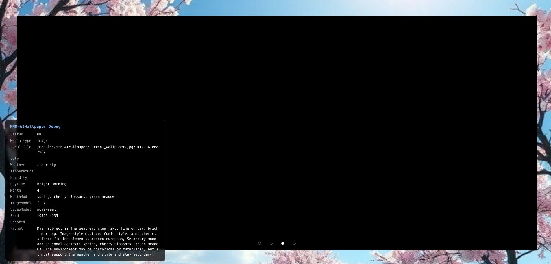

          @ajocham Great idea! I have tried the module on my MagicMirror and it works, somewhat… A few thoughts:
          Public keys seem to be deprecated in pollinations.ai and you can no longer create them on their website. The module seems to work fine with a secret key though, which I created and used. Perhaps you could change that in the README to prevent confusion for future users.
          The module does generate and download images. Unfortunately, in my case the image does not appear properly as a background image but modules will appear on top of the background with a black background. In my main.css I have defined a 60px gap between the edges of the screen and my modules. Only there the image appears…
          This is what my module configuration looks like:

          Any ideas?

            @CuddlyCow @ajocham
            I am still kind of new to this, but I am seeing a similar problem. I was trying to create a page with just weather related modules. Currrent, forecast, rain map and thought that adding this as a background would work, but I get the black box as well. So, I removed one module at a time until the only one I had left was the background module and still get the black box. I turned on Debug and it said it was ok.
            The config is essentially the example on, with sk_ instead of pk_ as mentioned and changed the city.
