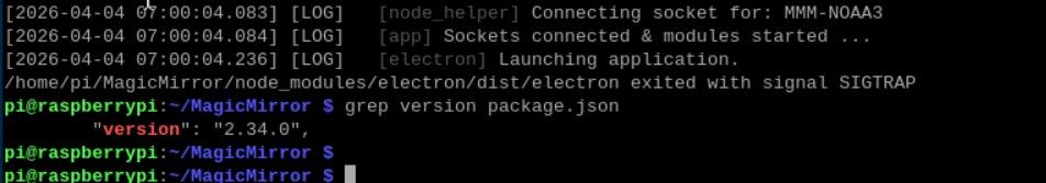

                    @sdetweil Hi Sam. I upgraded using your upgrade script. Then I saw the following error, /home/pi/MagicMirror/node_modules/electron/dist/electron exited with signal SIGTRAP. MM shows that it has started but browser does not launch, Electron failing. Tried a bunch of things but nothing seems to help. Switched back to X11 and still getting the dreaded error.
                    I have downgraded to 2.34.0 and still same issue now.
                    I am flashing a new SD card now and will try a fresh install and see how that goes

                      After downgrading, did you run
                      npm install again
