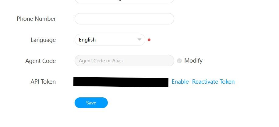

          @nowayto I have made changes to the module to accommodate the API key, however, when I tested it, it did not work for me.
          The Growatt NPM module states the following:
          You can get the key by having an email sent to you on the Grwatt website for a third party to display the data. The key is the combination of numbers and letters in the link. It has 96 characters.
          The API key I am seeing is much shorter than the 96 character key mentioned above and as a result I was getting a 500 error when I was testing it.
          This is obviously the wrong key.
          As such, I am reluctant to push changes I am unable to test successfully.
