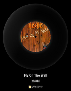

      MMM-SpinTheWheel
      Do you have hundreds of records and never know what to play?
      MMM-SpinTheWheel turns your Discogs collection into a vinyl roulette for MagicMirror². Spin the wheel, discover forgotten gems, browse album artwork and view track listings directly from your mirror or mobile phone.
      Features
      • Loads your Discogs collection
      • Random record selection
      • Realistic spinning vinyl animation
      • Mobile web interface
      • Track listing viewer
      • Front and back cover browsing
      • English, Swedish and German translations
      Screenshots

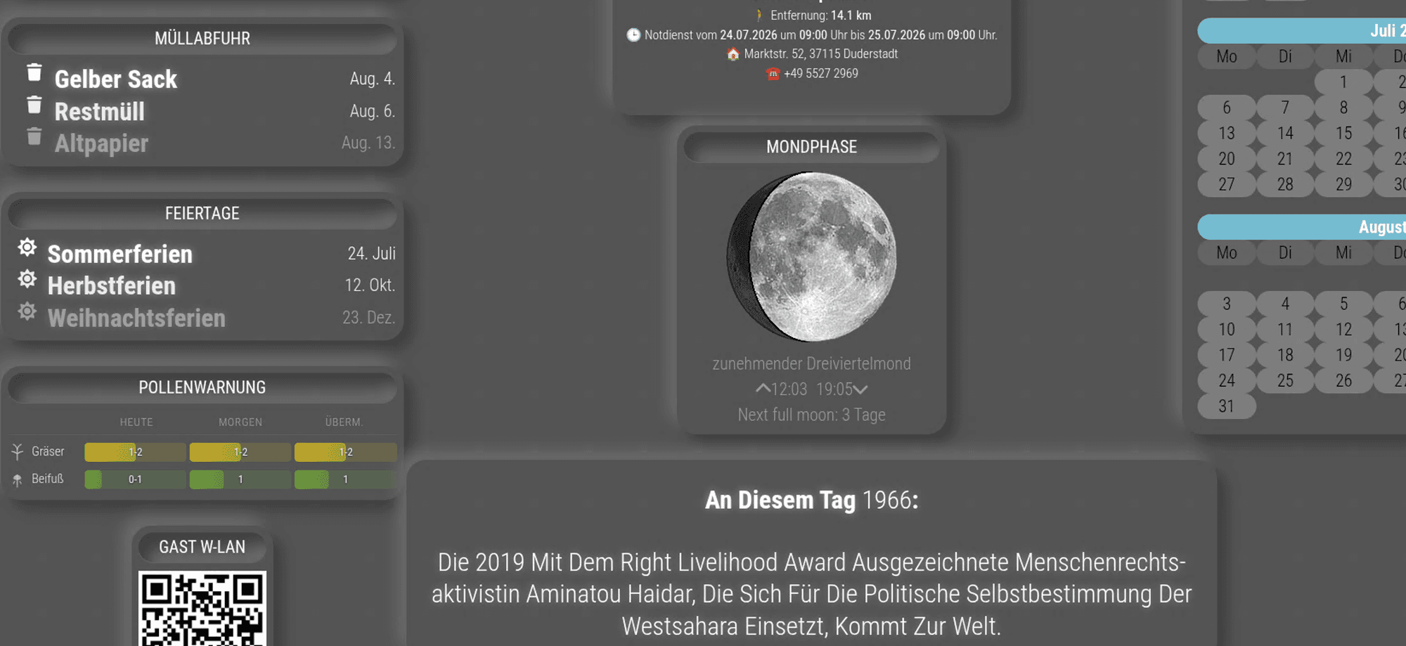

                    @Dentrass-0 Thank You. I still have another problem. The Font Size changed on other modules when I use your module. I also open an Issue at Github. At the Screenshot it is the calendar and the “an diesem tag”.

                          it is working fine, but the font size of the other modules still changes when I activate your module.
                          Regards
                            sdetweil @Niggich
                            @Niggich sounds like the css is not targeted at this module, but general
                            .small
                            Vs
                            .module_name .small
                            I didn’t check the module source
                            NiggichN 1 Reply Last reply Reply Quote 0

                              @sdetweil I don’t know, but at the style css from the module it looks like this.
                              /* ===== TEXT ===== */
                              .title{
                               font-size:30px;*/
                               margin-top:20px;
                               font-weight:600;*/
                               color:#fff;
                               text-shadow:0 0 10px rgba(255,255,255,.4);*/
                              I changed the css like this and everything is fine, but the title from the module is too small…
                              .title{
                               /*font-size:30px;*/
                               margin-top:20px;
                               /*font-weight:600;*/
                               color:#fff;
                               /*text-shadow:0 0 10px rgba(255,255,255,.4);*/
                              THX
                                sdetweil @Niggich
                                @Niggich make it
                                . MMM-SpinTheWheel .title {
                                  Copy rest of old title
                                Or edit the style.css and add
                                .MMM-SpinTheWheel
                                In front of each class def -add space after this addition
                                I submitted a pull request to do this
                                NiggichN 1 Reply Last reply Reply Quote 1
                                • NiggichN Offline
                                  Niggich @sdetweil
                                  @sdetweil I edited the style.css and add .MMM-SpinTheWheel in front of each class def and it’s working like I want. Maybe @dentrass-0 can fix this for everybody on GitHub.
                                  THX
                                    sdetweil @Niggich
                                    @Niggich I submitted a pull request to the repo yesterday for this
