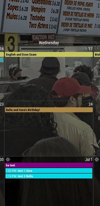

            sdetweil @Jk1
            @Jk1 try
            .CX3 .headline {
              color: var(--calendarColor);
            from here
            https://github.com/MMRIZE/MMM-CalendarExt3#styling-with-css

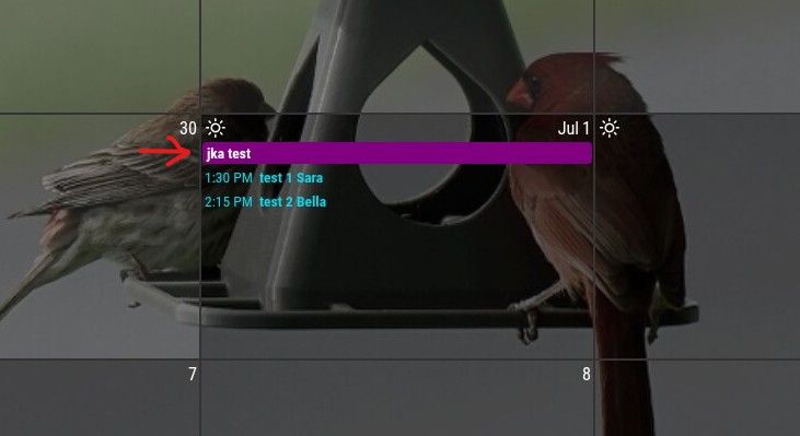

              Jk1 @sdetweil
              @sdetweil That didn’t work either. Here’s my custom.css file… maybe something sticks out to you?
              I appreciate the help.

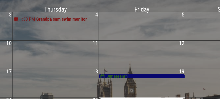

                    ok, tried again
                    .CX3 .event .headline {
                      color: green;
                    J 1 Reply Last reply
                    • J
                      Jk1 @sdetweil
                      @sdetweil right the Juneteenth is a full day event (holiday) so it has a colored background. But your timed event on the 4th is just colored text. I am able to make it do that too.
                      BUT what I want is the timed event, “Grandpa sam…” to also have a colored background like “Juneteenth” ( but of course a different color since it’s not a holiday).

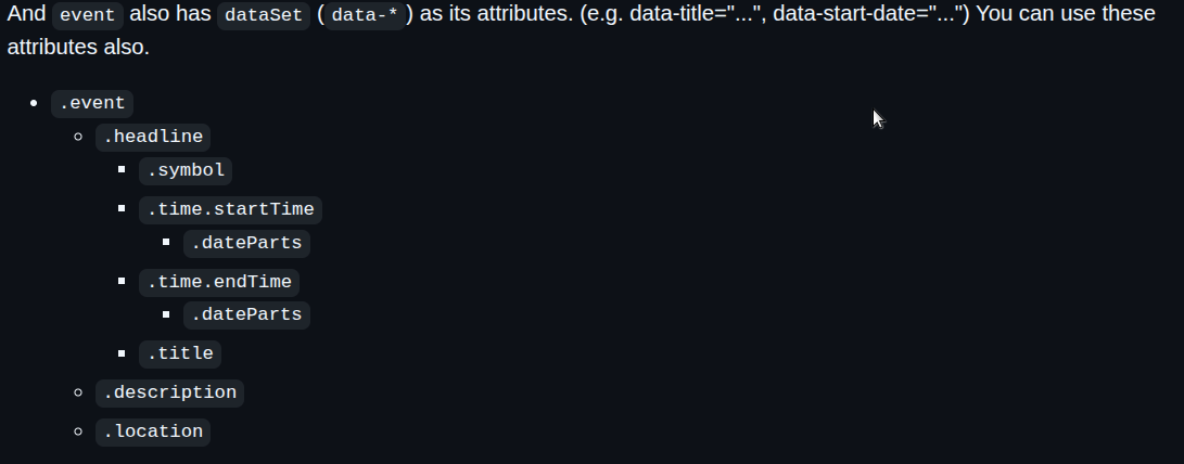

                        @Jk1 yeh, css has this other core idea,
                        The selector that is MOST specific wins, regardless which was defined last
                        So, if you target a big blob, and another targets THAT big blob, the second one wins.
                        If you look at the css file provided by the module (same folder) you will see how it targets different elements
