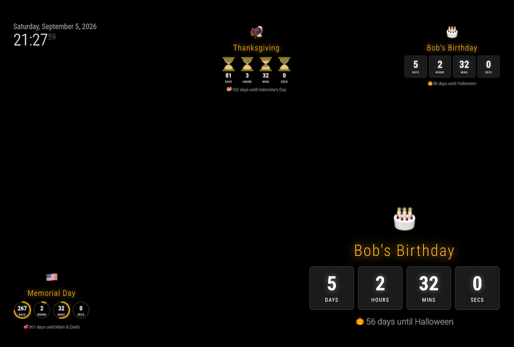

                trnitz @plainbroke
                @plainbroke said:
                @trnitz
                Pretty cool little module, Do you have a way to enlarge it 2 or 3 times as large???
                You can do this using your custom.css file.
                If you have a single instance of this module running, simply add this to your custom.css file:
                 .MMM-EventCountdown .event-countdown {
                      zoom: 2; /* fractional number also accepted */
                If you have more than a single instance of this module running, add a unique classes value in config.js:
                    module: "MMM-EventCountdown",
                    classes: "countdown-large",
                Then, in your custom.css file:
                 .MMM-EventCountdown.countdown-large .event-countdown {
                      zoom: 2; /* or 1.5, 3, etc... */
                Any fraction of a number, such as 1.5, 2.25, etc, will also work.
                Screen shot of it set to 2:
