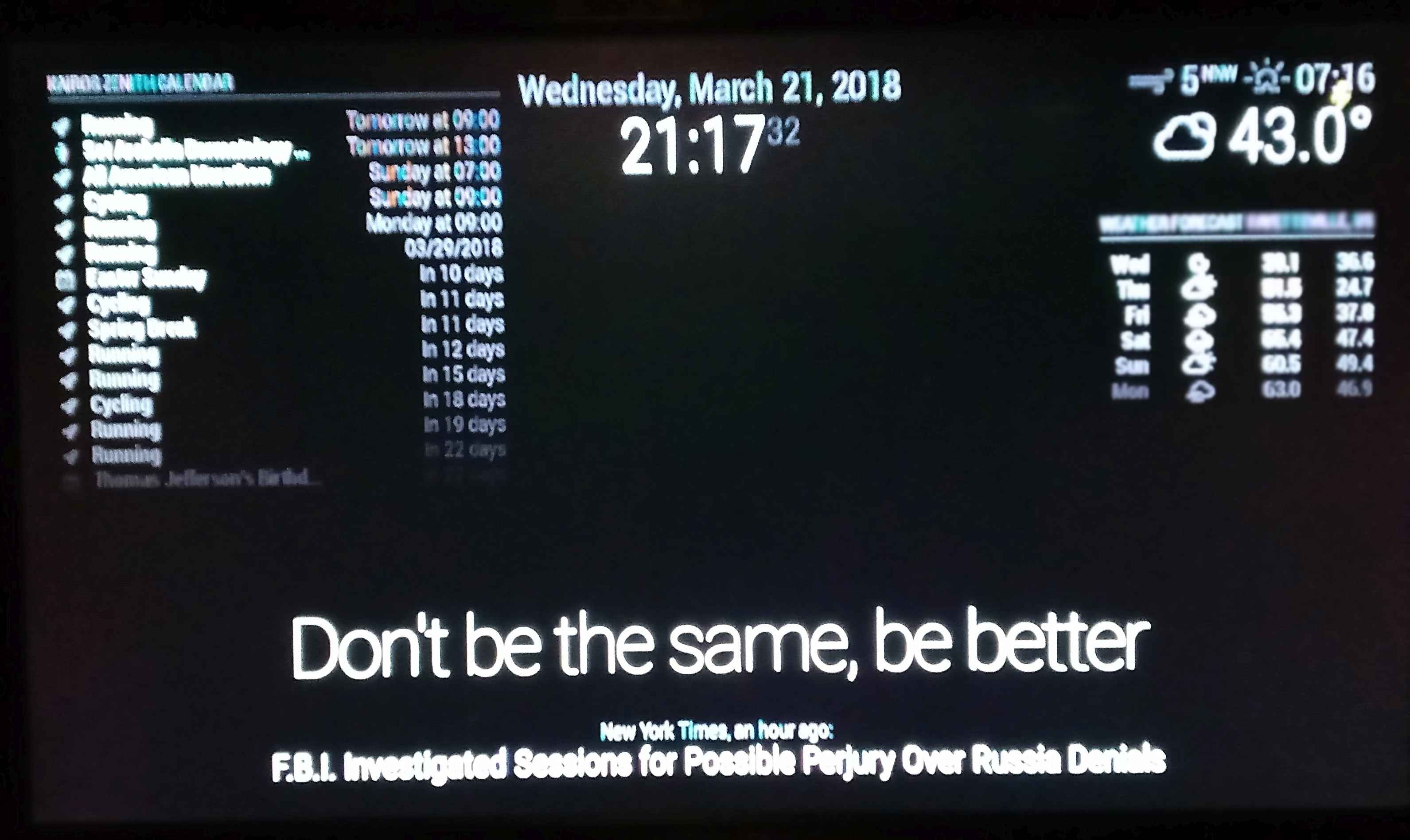

      i have a TV turned normal landscape mode for my Magic Mirror. i have the calendar (schedule) on the left and weather on the right. i have the clock in the middle. i want to separate the date from the clock and leave the time in the middle, but put the day & date above the calendar on the left. i tried something that i thought was going to work, but it didn’t …
      i made a copy of the clock module and renamed that one, dateclock. i added that into the config file. i also renamed the clock.js file and it’s css file.
      i also changed the names on these two in the dateclock.js file:
      Module.register(“dateclock”,{
      // Module config defaults.
      … and also …
      / Define styles.
      getStyles: function() {
      return [“dateclock_styles.css”];
      i didn’t change these two at first, but was hoping it would help since it still had the original clock names in them. Is there some other files that make these modules work, besides the three that i have worked with here (config.js, clock.js, clock_styles.css)?? i have just a little experience with linux and coding, so i don’t know what i’m doing wrong. Thanks for any help :)

          Thanks a lot for the advice. i don’t know why i didn’t even think about the fact i was putting it in the default folder. It works now. i just had to take out one line of code (line 179) that was for the digital clock (timeWrapper). i know it is leaving in a bunch of unnecessary code in there, but i don’t know enough to take that stuff out, so i’m going to take the easy way out, lol. Then all i had to do was turn off the date in the clock module (in the middle of my screen).
          Now, i just have some minor cosmetic issues to work out, like the fact that i can’t get the weather forecast to keep the line at the top, even when there’s no location on it’s header (i needed to take the location out to save space underneath the forecast), even though i wanted to keep the line to help show some separation between the current weather & the weather forecast modules .
          Now i’m working on getting the YouTube casting module put in the center of everything. i just don’t like that they didn’t use the regions from the Magic Mirror code, they gave it their own defintions, so i can’t line it up perfectly underneath the clock. It centers it in the middle of the screen and my clock isn’t centered in the screen. It is slightly to the right. Another issue i’m seeing is that once you use the video casting, it doesn’t close it out when you’re done. i was going to make the video bigger, but since it doesn’t automatically close, i’ll just have to make it fit the space in the middle, so that it doesn’t cover anything. Thanks again, so much for the help.
