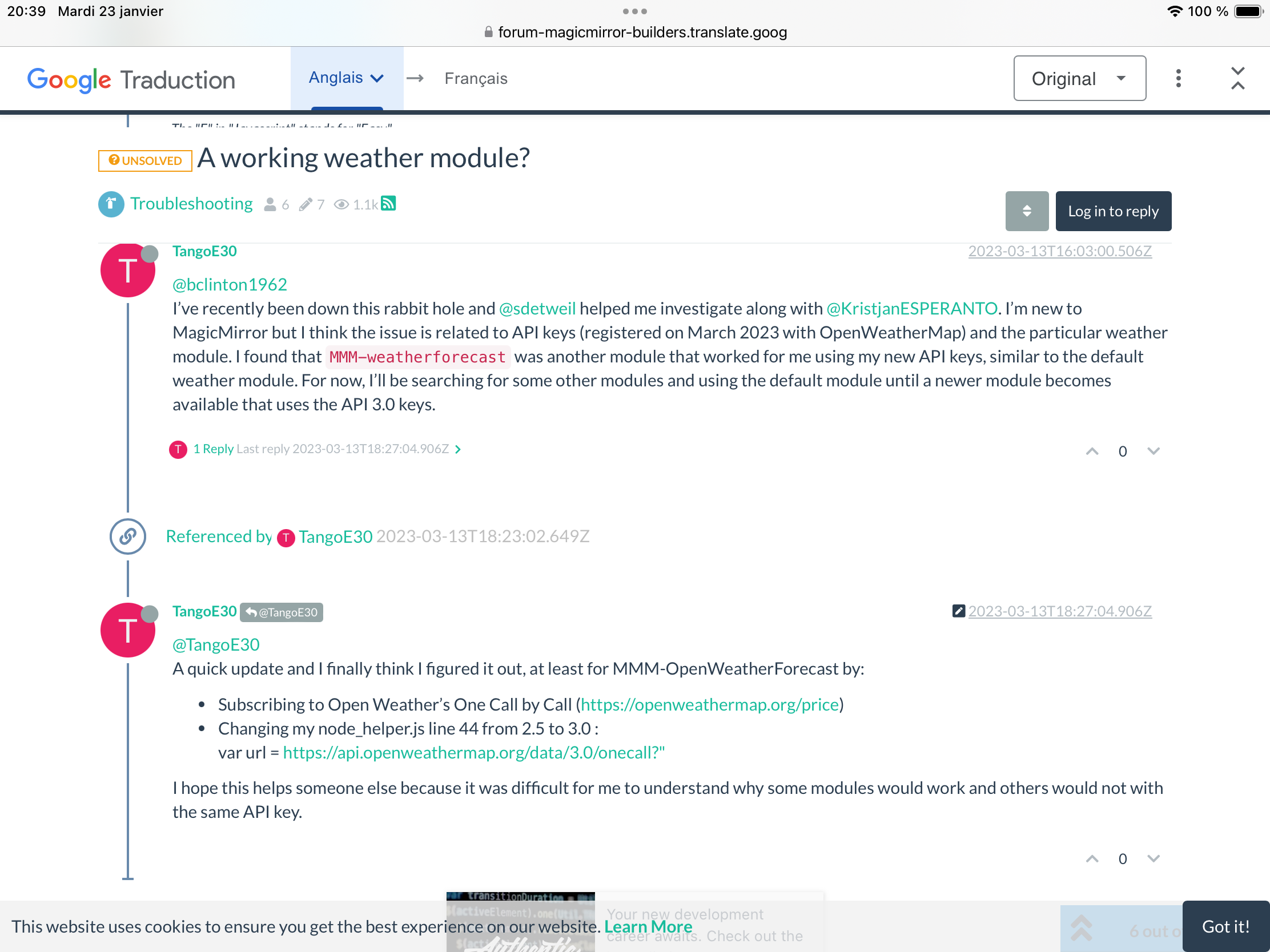

                        manu85340 @sdetweil
                        @sdetweil I found a post from March 2023 where we talk about you on the same subject 😉
