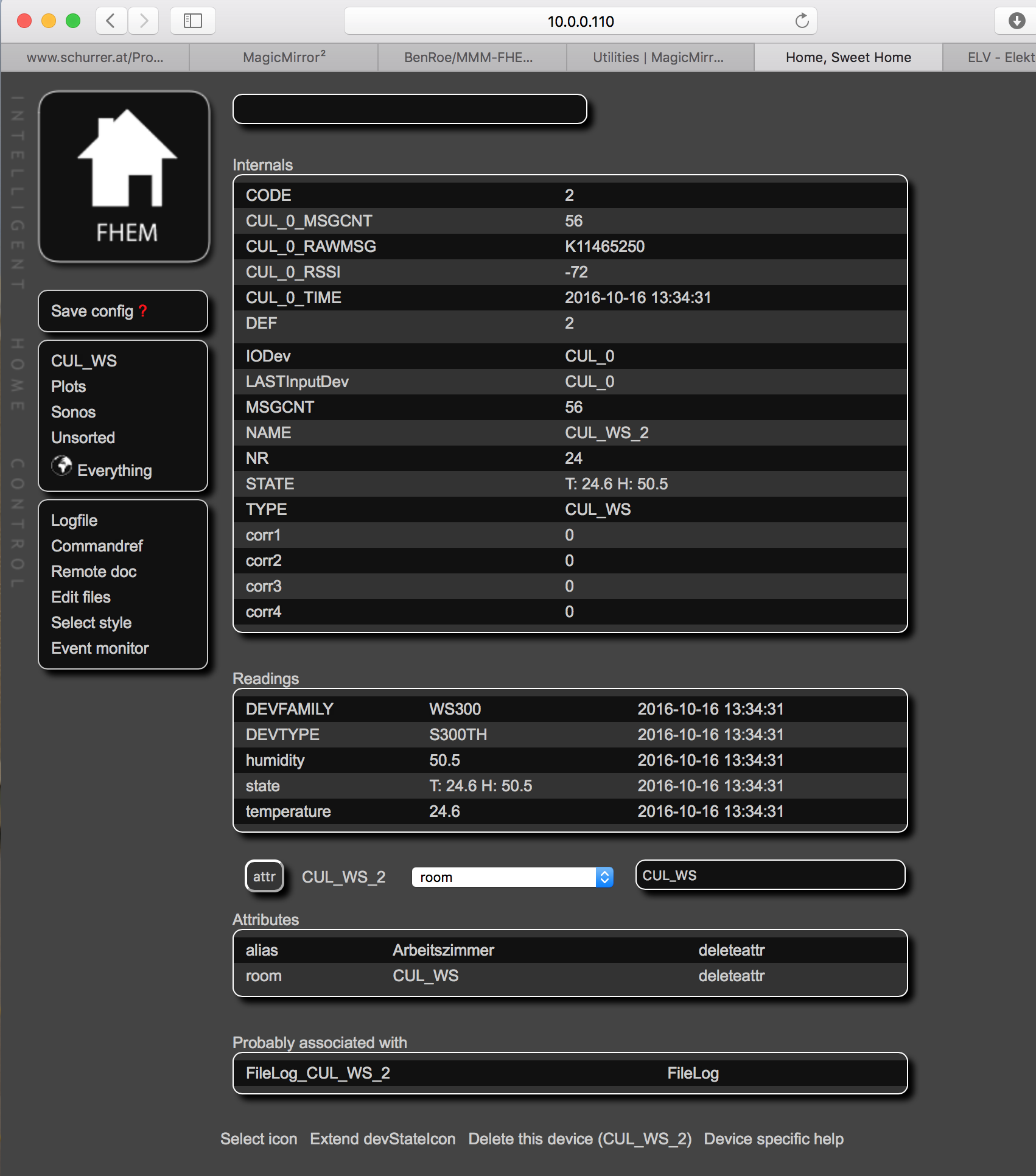

      i tried it with the following config but i can’t finde anything on the screen. the module is installed as i can see that it is listening to events in the debug mode.
                          module: 'MMM-FHEM',
                          position: 'top_left',
                          host: '10.0.0.110',
                           deviceNames: [
                                  'CUL_WS_1',
                                  'CUL_WS_2'
                          deviceReadings: [
                                  { name: 'temperature', icon: 'wi wi-thermometer', suffix: '°' },
                                  { name: 'humidity', icon: 'wi wi-humidity', suffix: '%' }
      FHEM is also up and running:
      Thanks a lot
      Christoph

            @gismo2006 yes, in the readme file host is defined as an IP address. I can access FHEM from the MM Pi.

                    FHEM on 10.0.0.110 (as you also can see on the screenshot above)

                      As you see on the screenshot cpramhofer is able to connect to the management website in a browser, so the IP address should not be the problem.
