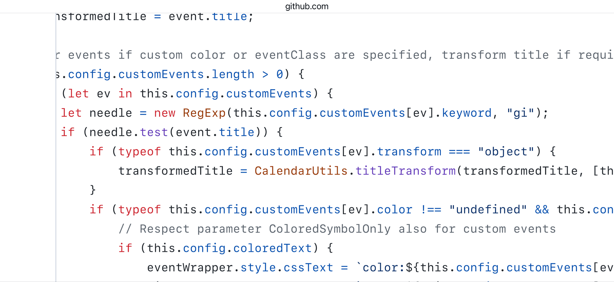

                        @daportelli I’m not sure of the effect, but the keyword is treated as a regular expression. I don’t know if single quotes make a difference
                        Also don’t know if js regex works the same, from the code

                          The comments in the code are very confusing, but I think I get it now, more or less.
                          Try this:
                          {keyword: '.*', transform: { search: 'Spotify', replace: 'Music'}},
                          {keyword: '.*', transform: { search: 'Canterbury-Bankstown Bulldogs', replace: 'Bulldogs'},
                          The keyword is the event title string you want to change, in format regex.
                          The search is the substring that you want to replace, in format regex
                          The replace is what will be replaced based on your search
                          So in this case, let’s say the event title string is:
                          ‘Spotify play list’
                          Then you search the complete string (.*) for the substring from search and you replace it by the string from replace.
                          Hence, the event title now becomes:
                          ‘Music play list’
                          I hope it is a little bit more clear.
