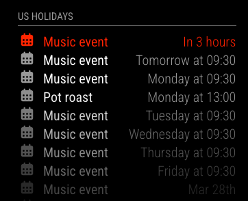

                          sdetweil @daportelli
                          @daportelli ok, I just setup an event, happening every day
                          ‘Spotify Event’
                          added the custom event def you showed
                                                  header: "US Holidays",
                                                          customEvents: [
                                                                  { keyword:'.*', transform :{ search:'Spotify', replace:'Music'} }
                                                                          symbol: "calendar-check",
                                                                          url: "https://ics.calendarlabs.com/76/mm3137/US_Holidays.ics"
                          and got this result
                          MM 2.34
                          I changed the customEvent definition to
                          { keyword:'event', transform :{ search:'Spotify', replace:'Music'} }
                          and it produced the same resutlts
