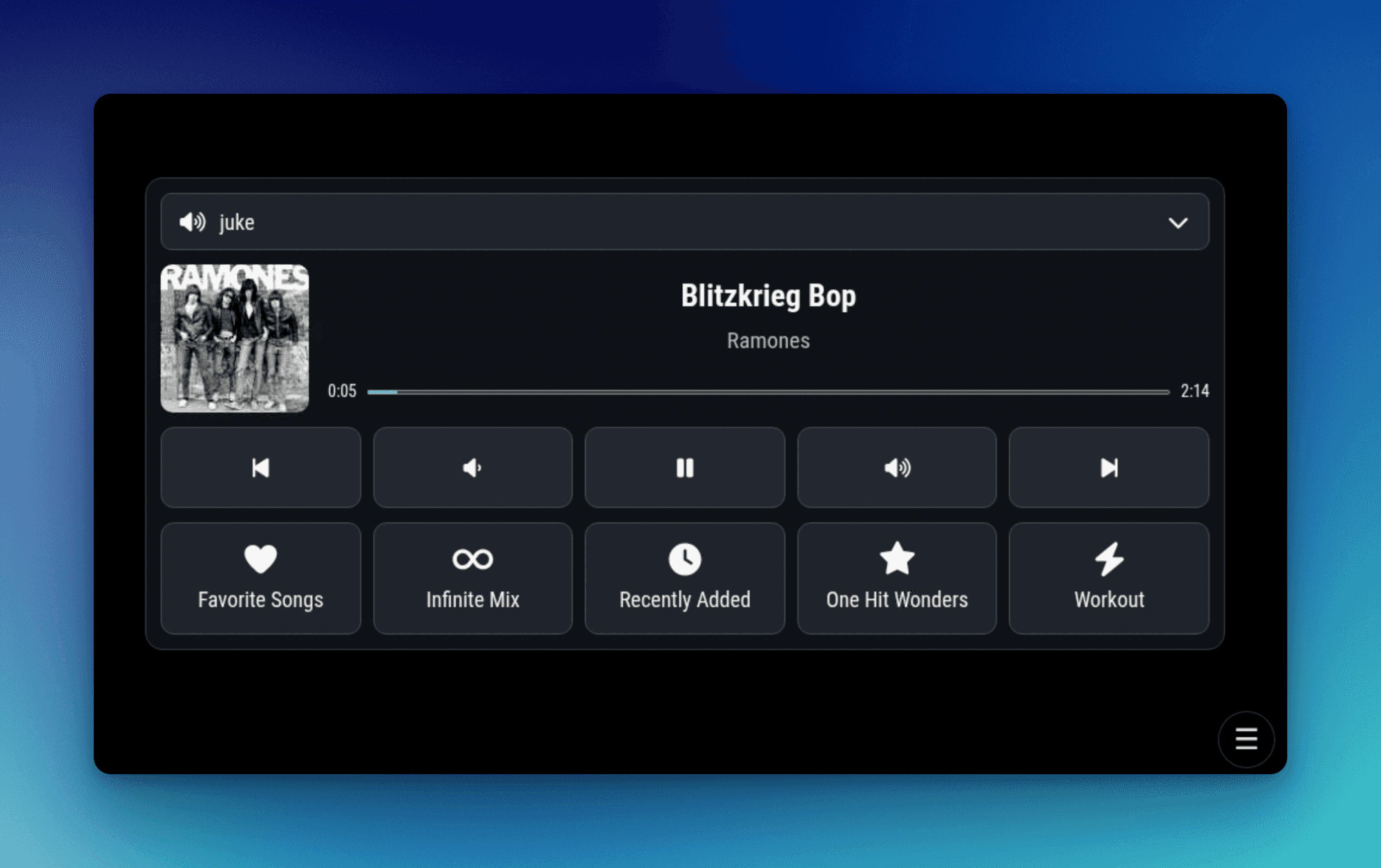

Seymour — my modern take on the 3Com Audrey
I’ve been working on a small ambient information appliance called Seymour.
The inspiration is the original 3Com Audrey internet appliance. Seymour is built around a Raspberry Pi, a 7-inch touchscreen, a rotary encoder, an illuminated WLED ring, an internal speaker, and a 3D-printed enclosure. I chose MagicMirror because its module ecosystem already provides most of the useful building blocks.
Instead of presenting everything as one dashboard, Seymour organizes modules into channels. Pressing the encoder opens the channel selector, rotating chooses a channel, and pressing again opens it. The touchscreen is also available.
The current prototype includes clock, weather, news, calendar, messages, a kitchen timer, and local music playback through Music Assistant. The LED ring provides status and attention feedback, while the speaker handles music and timer sounds.
It is still a working prototype, although it may already be close to the finished personal appliance I wanted. I’m continuing to polish the documentation and software before making the repositories public.

Thanks! Here is a look inside.
It is definitely a little packed in there. The Raspberry Pi runs MagicMirror, with the rotary encoder as the main physical control. There is also a small D1 mini running WLED for the illuminated ring, plus the internal speakers and amplifier.
A lot of the fun has been making all of those pieces work together. Turning and pressing the dial controls the channel selector, the LED ring can change based on status or notifications, and Home Assistant ties into it for messages and other events.
The enclosure is 3D printed and has gone through quite a few revisions to get everything to fit. Still needs a revision to fit my hands!
I am still cleaning up the code and documentation, but I am happy to share more of the hardware, wiring, software setup, or some of the failed prototypes if anyone is interested.
