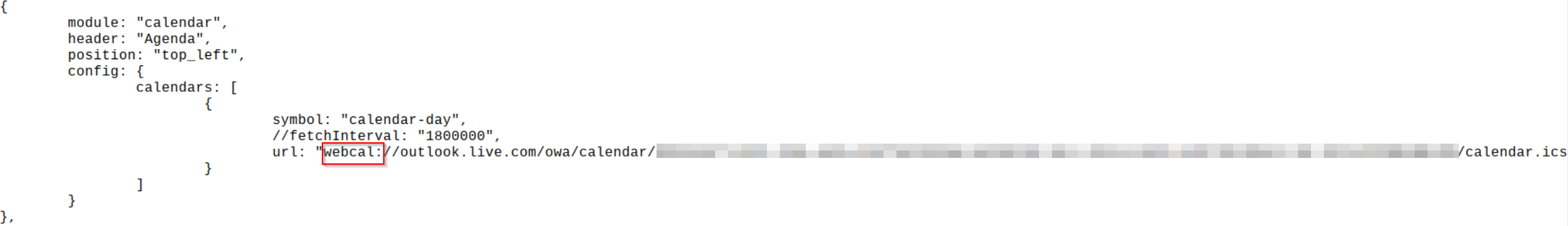

        It seems that the calendar sharing function of O365 has changed again…
        But I got it to work, see the following instructions and screenshots:
        1. Visit Outlook Calendar Online App (e.g. https://outlook.live.com/calendar)
        2. Go to Settings (in the upper right corner of the window):
        3. Show all Outlook Settings (or however this is called in English :-) )
        4. In the settings window, go to “Calendar” > “Shared Calendars”:
          You should now see here two url (html and ics). If not, you first have to choose a calendar (at “Einen Kalender auswählen”) and set the Permissions.
        5. Copy the .ics url and put it into your config.js file for your MagicMirror
        6. IMPORTANT: Replace the “https” of this url by “webcal” (as it is for the default calendar):
        This worked perfectly fine for me, but who knows, maybe Microsoft will change this procedure again in a half a year or so… :/

          @burgi Thank you for this! I was dreading having to think about pulling my O365 calendar into Google. These directions worked perfectly, and it was simple to bring my calendar directly into MM. Thanks!
