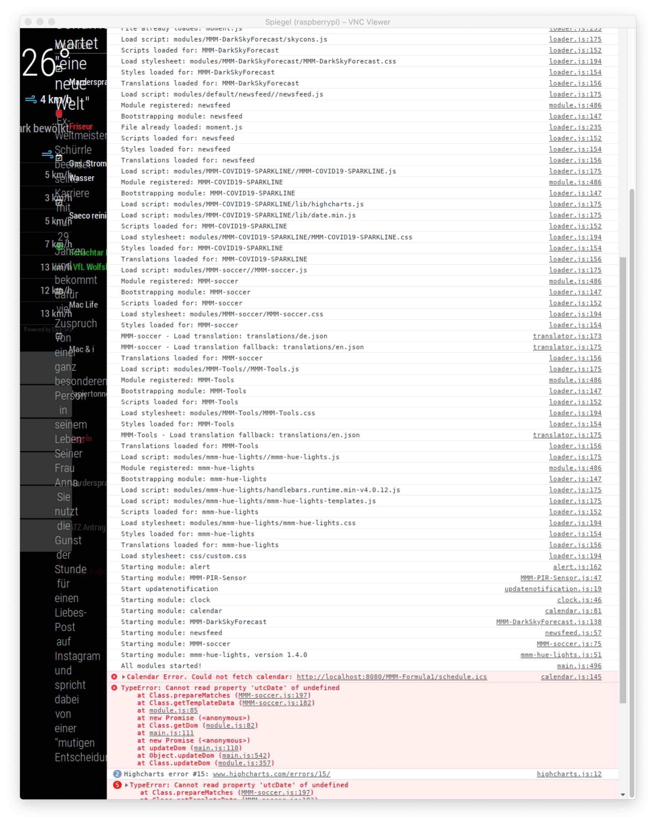

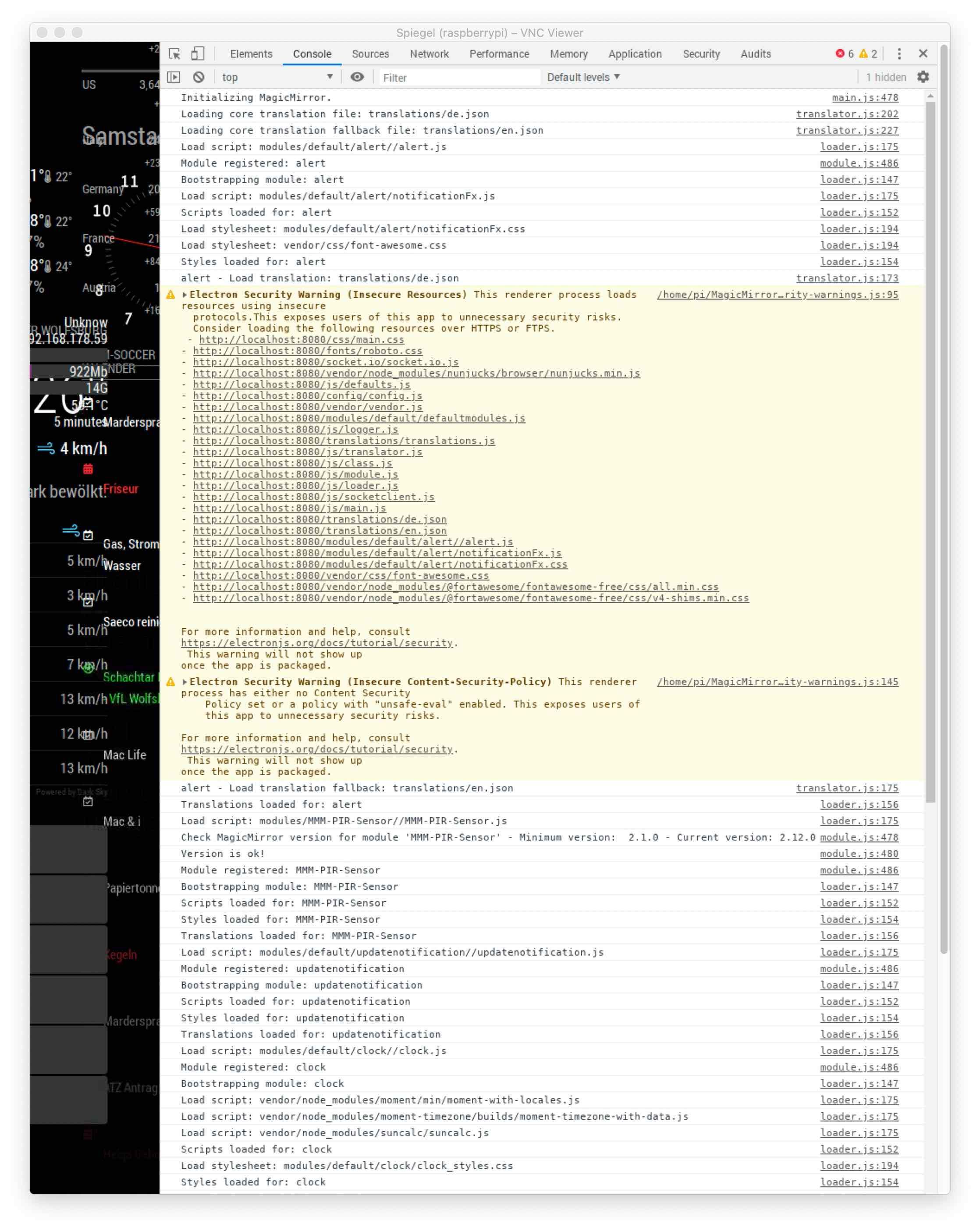

          sdetweil @JoeFranz
          @JoeFranz ok, nothing obvious there, so, now we need to open the developers window, ctrl-shift-i and select the console tab and scroll up to see any errors, usually red text
          • J Online
            JoeFranz
            This post is deleted!
            • J Online
              JoeFranz @sdetweil
              S mumblebajM 2 Replies Last reply Reply Quote 0
                sdetweil @JoeFranz
                @JoeFranz looks likes is mmm-soccer w the problem
                • J Online
                  JoeFranz
                  Without MMM-soccer same error :-(
                  • mumblebajM Offline
                    mumblebaj Module Developer @JoeFranz
                    @JoeFranz Looks more like an issue with the MMM-Formula1. It is the first thing throwing an error. Can you write the npm to file and post the contents of the log file?
                    npm start > log.txt 2>&1
                      sdetweil @mumblebaj
                      @mumblebaj there were no errors in the npm start log info.
                      the calendar error is not fatal.
                      the soccer error is fatal, as it’s in the web drawing loop.
                      @JoeFranz u can’t have the ‘same’ error if u disabled the soccer module
