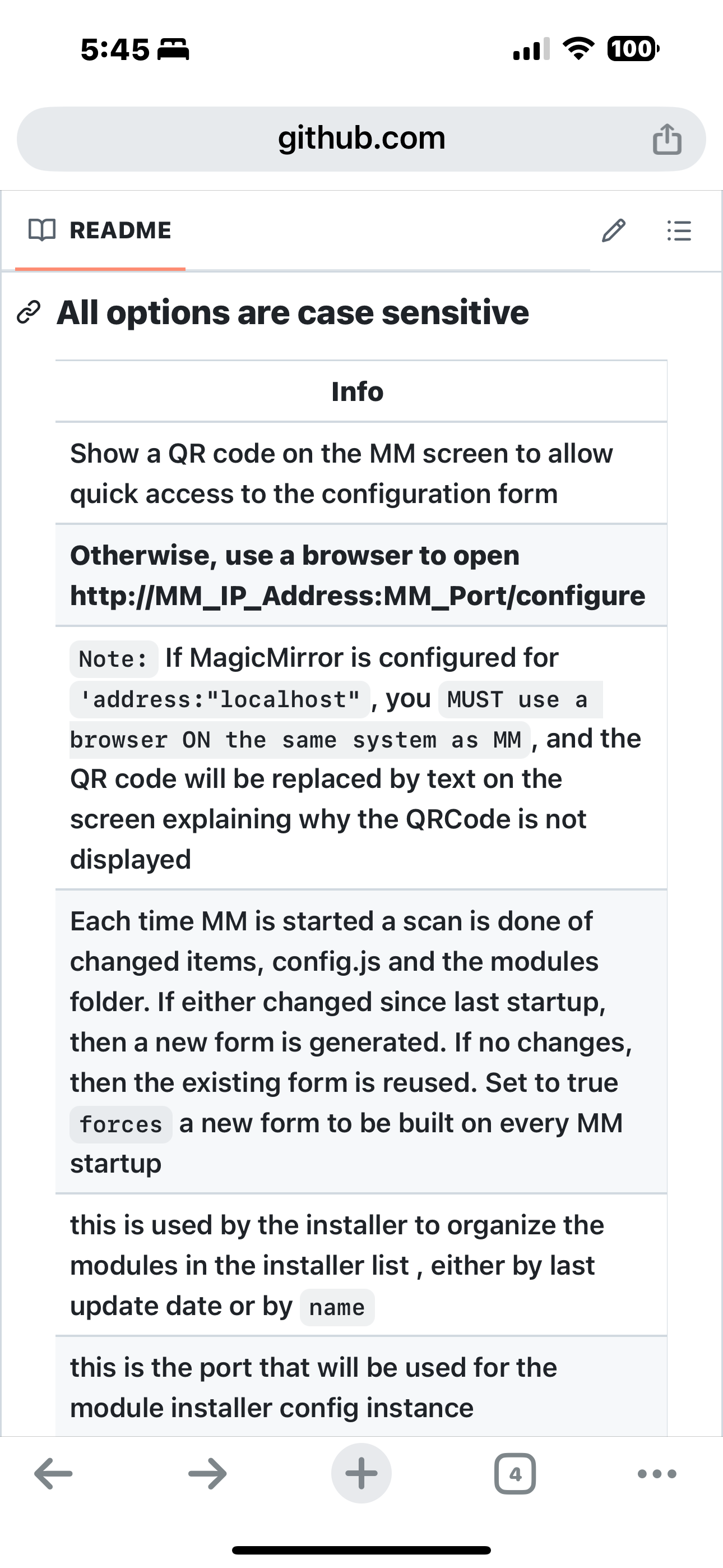

            I am a noob at this, how do I set the port to use the browser and how do I show the QR code on my MM?
              sdetweil @DarkV
              @DarkV the default port is 8080
              you can edit in config.js and change the number, or change it in the form
              and in the MMM-Config config set showQR to true
              the doc mentions how to open the form directly in a browser
              note on the QR you MUST change config.js to support outside MagicMirror system access, per the doc

                    @DarkV the doc (README.md) says the url
                    D 1 Reply Last reply
                    • D
                      DarkV @sdetweil
                      @sdetweil Apologies for my lack of knowledge, but I didn’t fully understand your response about the URL. Please keep in mind that I’m not very experienced with coding.
                        sdetweil @DarkV
                        @DarkV it takes a little bit of info
                        a url contains
                        a protocol type secure(https) or not (http)
                        a server name or address
                        a port
                        a path
                        and optionally some parameters
                        for MMM-Config
                        just protocol, server, port and path
                        on your local network, we dont need to build our everything for secure encrypted communications
                        if the machine you are opening the browser on is the same machine as MagicMirror is running, then you can use localhost
                        otherwise you need to know the MagicMirror server ip address or network name
                        the port value comes from the MagicMirror config.js, default is 8080
                        (if you dont see a port specified in a url, then the browser uses the default for the protocol, 80 or 443 not/secure, as appropriate)
                        and then the path, for MMM-Config there are two :
                        for configuration
                        /configure
                        and for module installation
                        /installer
                        http://ip:port/configure
                        on the same machine, using defaults
                        http://localhost:8080/configure

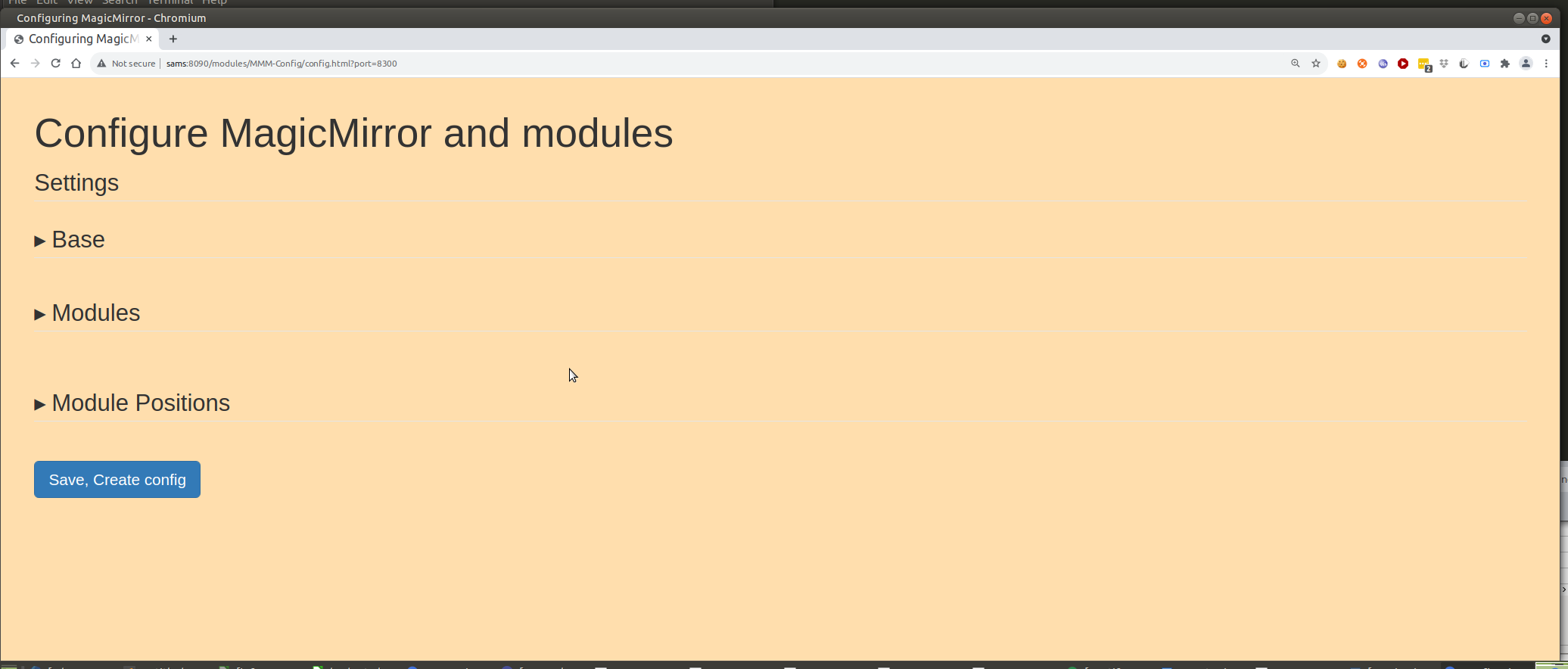

                          Hello, Newbie here, how do you go about using this? What do I need to get started? Do I need Node.js? Have it installed, yet completely lost. How about a guide or video. Thanks
                            sdetweil @IamWayne
                            @IamWayne did you add the module to config.js?
                            and restart MagicMirror?
                            if so then the url from the doc
                            http://ip:mm_port/configure
                            but by default the MagicMirror config only allows apps from inside the same system to connect, so you would have to minimize MagicMirror then launch a browser to
                            or for the module installer
                            http://localhost:8080/installer

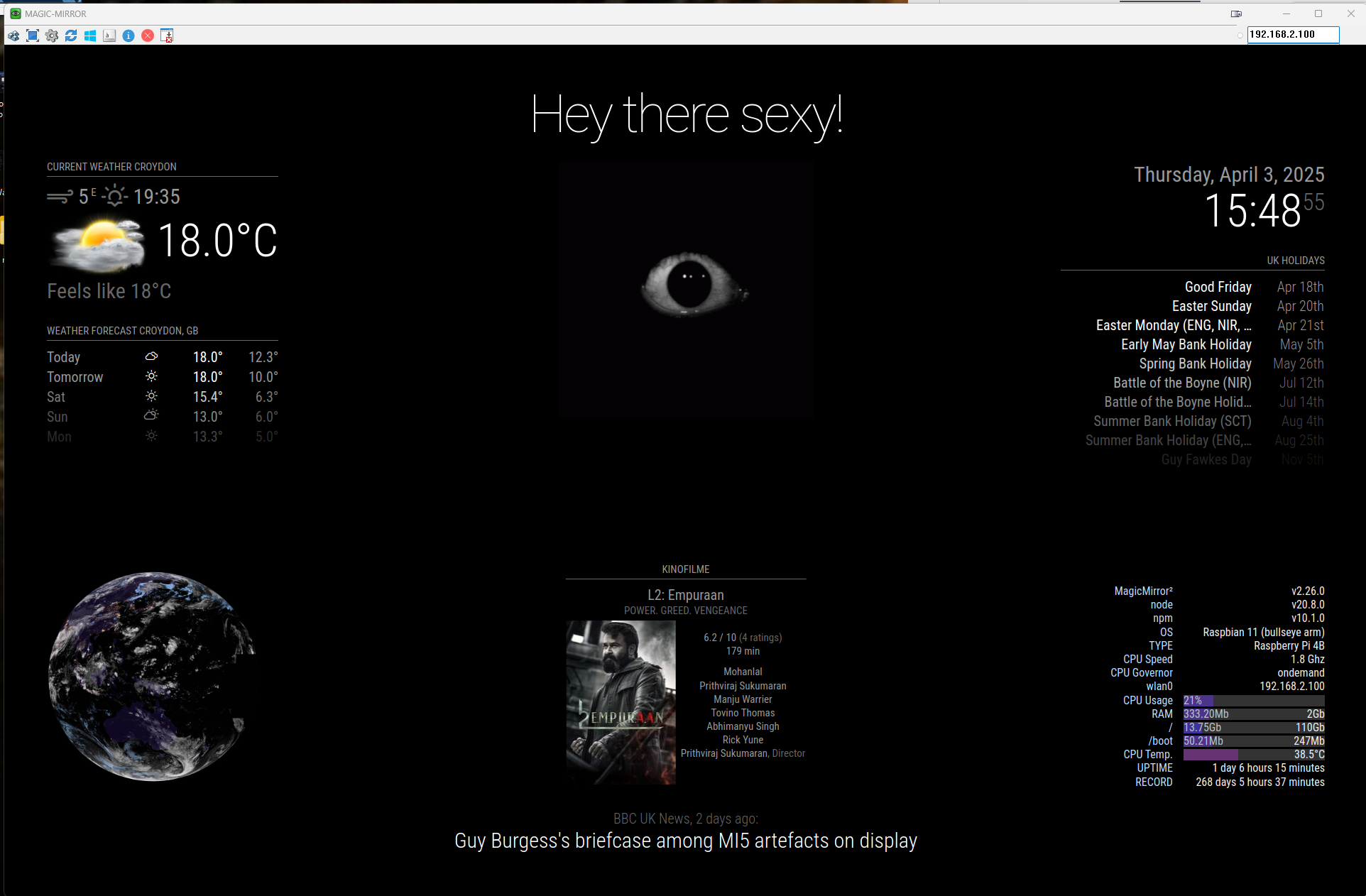

                                    @sdetweil Still no joy, I am going to reinstall.I cannot display the QR code as I do not have any zones left and cannot load the web page1.png Screenshot 2025-04-03 155111.png
                                      sdetweil @DarkV
                                      @DarkV you dont need the qr code
                                      can you show the messages from npm start?
                                      if using pm2 then
                                      pm2 logs --lines=100
                                      D 2 Replies Last reply
