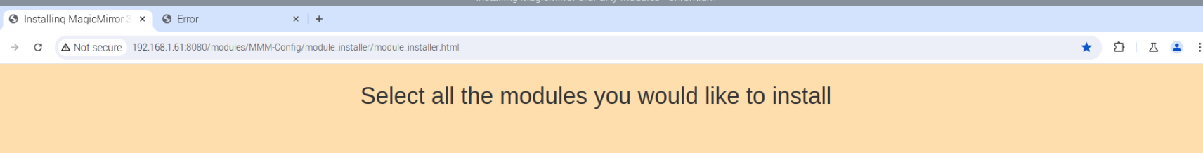

                in the browser i go to installer
                and this is all that loads

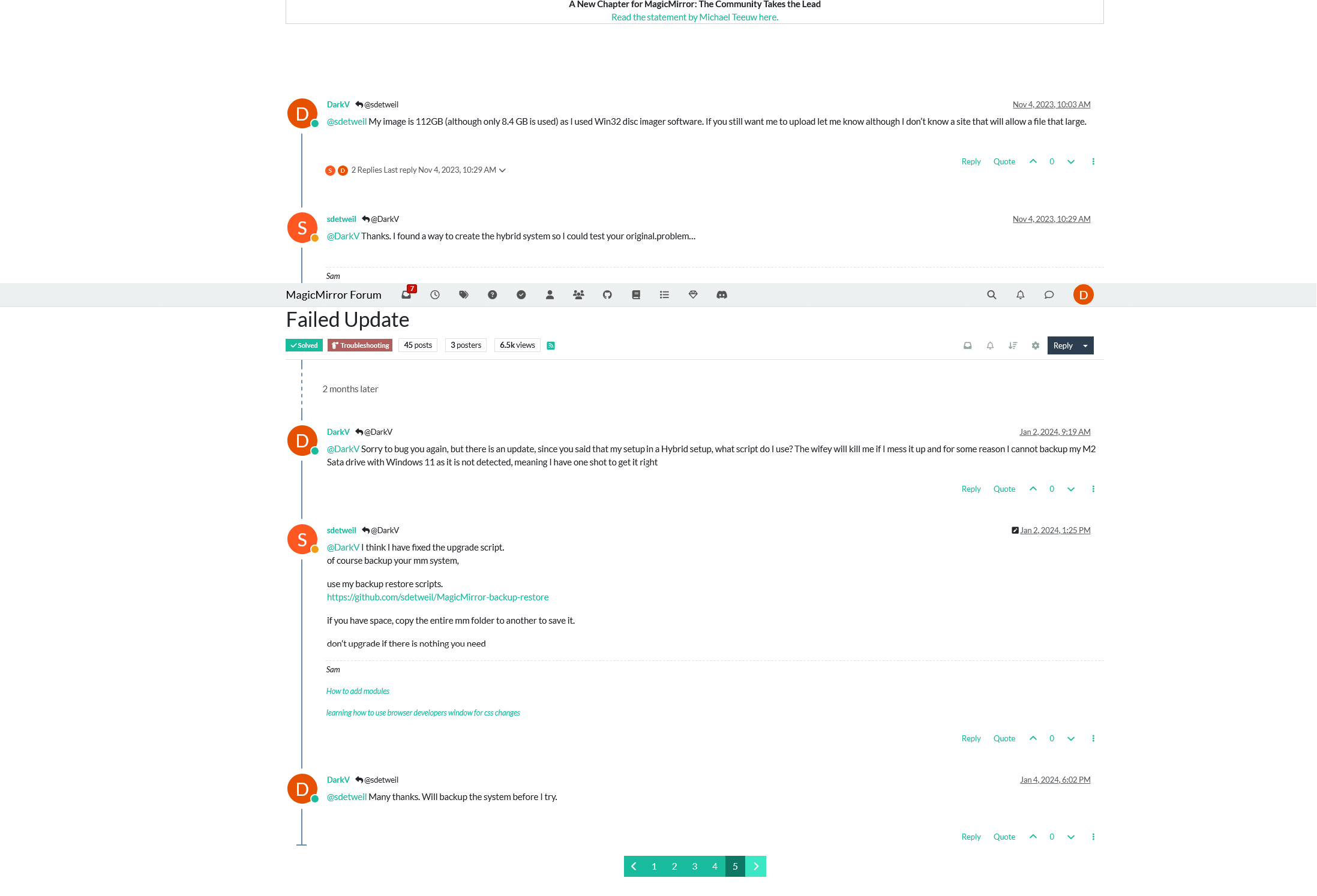

                    You helped me on a while backScreenshot 2025-04-10 at 11-54-21 Failed Update MagicMirror Forum.png
