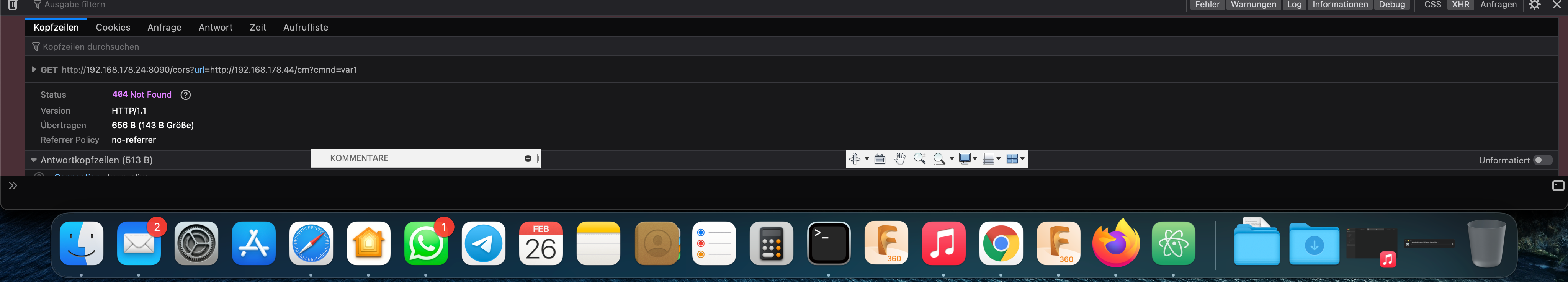

                        var requestURL = location.protocol + “//” + location.host + “/cors?url=http://192.168.178.44/cm?cmnd=var1”;
                        now I get this error:
                        cannot get /cors.
                        karsten13K S 2 Replies Last reply Reply Quote 0

                          you switched to develop and pulled the latest version of mm? Looks like not.
                            sdetweil @fischi87
                            @fischi87 here is how to get to develop branch, depending on how u installed
                            https://forum.magicmirror.builders/topic/14327/testing-new-fixes-or-solving-current-problems-with-next-release-code
                            F 1 Reply Last reply Reply Quote 0
