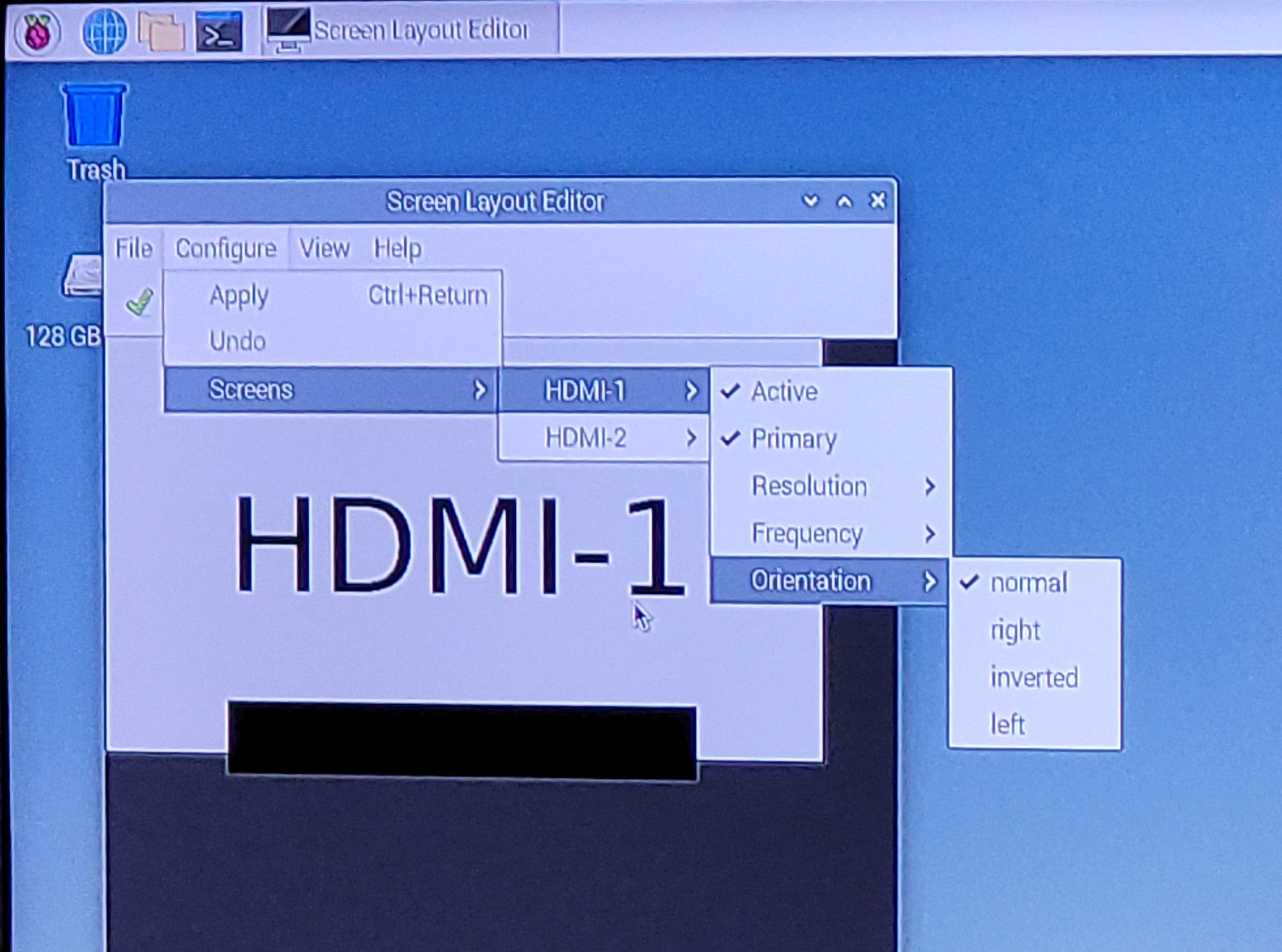

      I tried doing it from inside ‘X’ by using the Screen Configuration app, but when I do that (rotation=left), the screen goes black, and nothing happens, I can’t press the ‘verify’ button, so if I reboot it, it is still in landscape mode.

        sdetweil @fribse
        @fribse on my pi4 w bullets I see this config setting app
        left menu, preferences, screen configuration
        configure menu
        BKeyportB F 2 Replies Last reply Reply Quote 0

          • F Offline
            fribse @sdetweil
            @sdetweil Hi
            Yes I see that as well in bullseye, that is what I mean with ‘screen configuration app’.
            If I rotate it in that (to left), the monitor just goes black?
            @BKeyport it’s there in bullseye, but not previous versions.

              sdetweil @fribse
              @fribse I do not know. maybe a bad HDMI cable or a bad adapter if using HDMI to DVI, or a bad monitor?
              all my monitors and TV’s work in any orientation.
