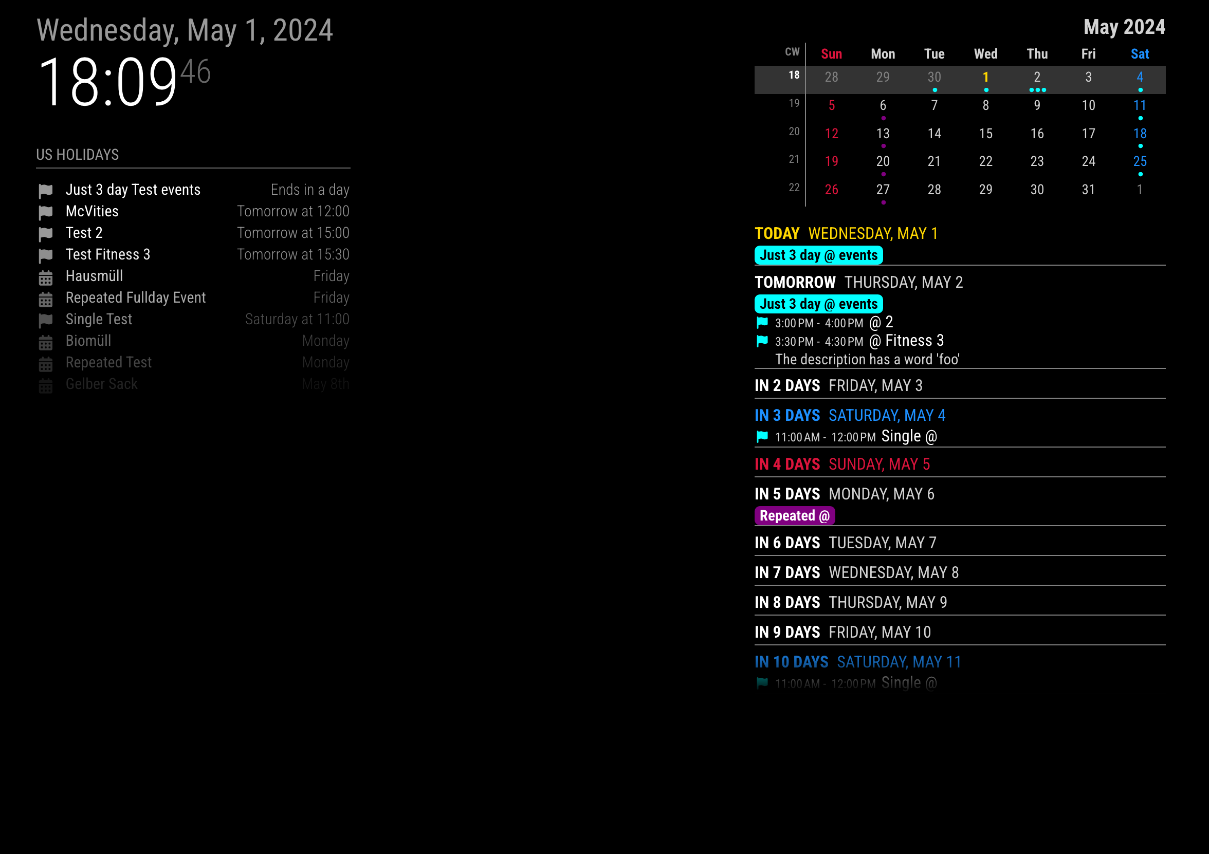

          You can see the result below;

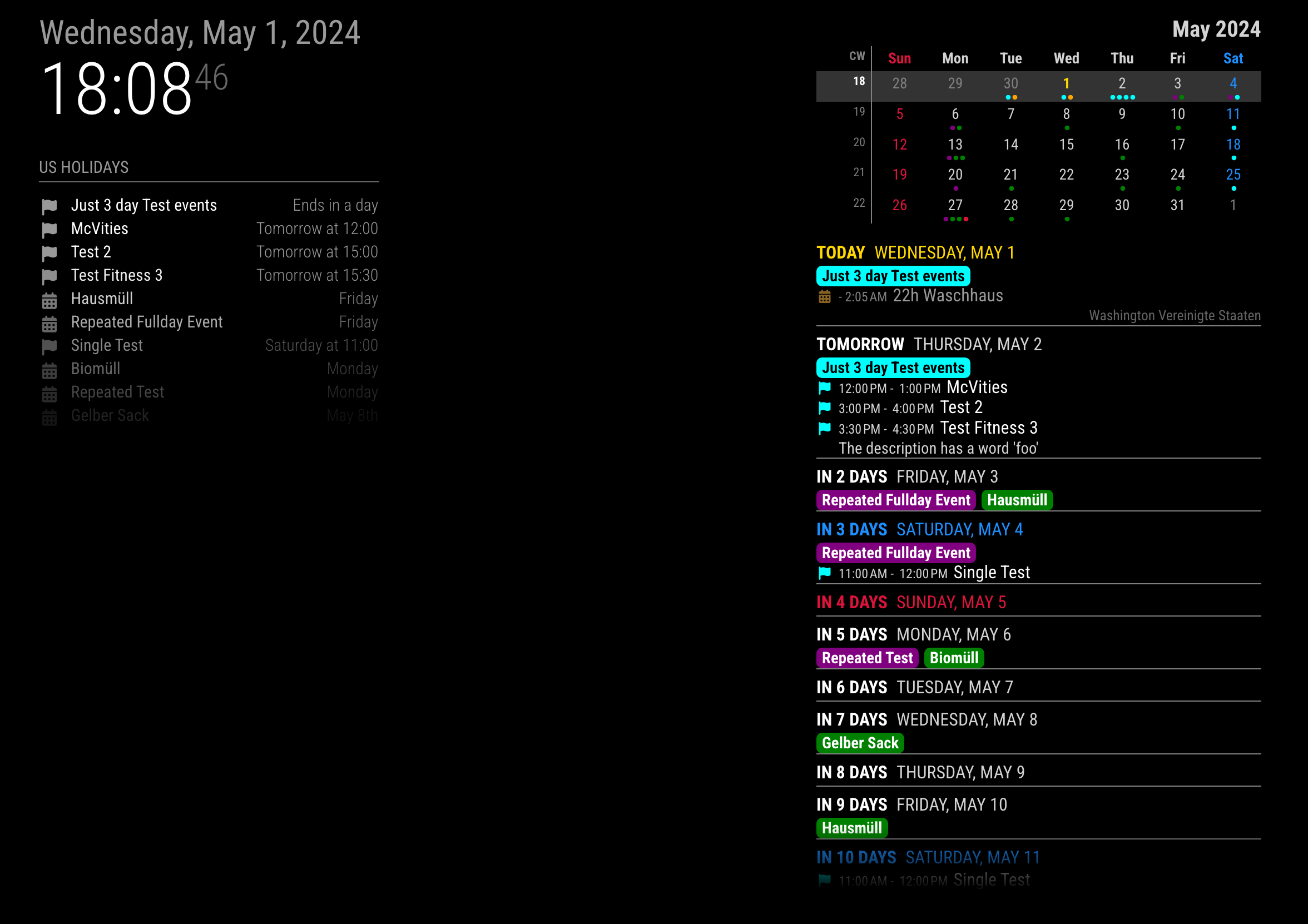

          ORIGINAL
          CONFIGURED
