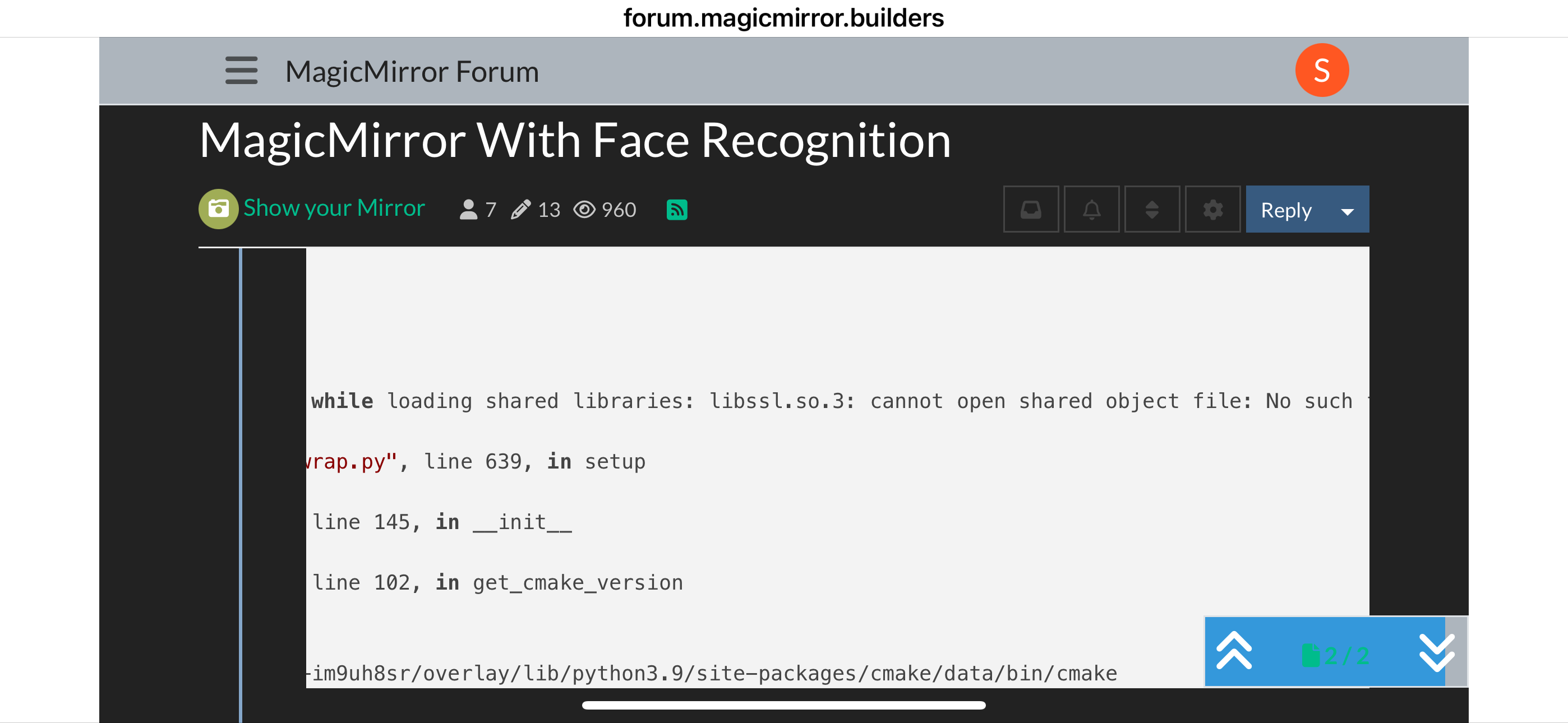

          /tmp/pip-build-env-im9uh8sr/overlay/lib/python3.9/site-packages/cmake/data/bin/cmake: error while loading shared libraries: libssl.so.3: cannot open shared object file: No such file or directory

              monark @sdetweil
              @sdetweil it’s strange because I’ve updated everything
                monark @sdetweil
                @sdetweil i try with sudo apt install libssl.so.3 but not working “impossible find the packet”
