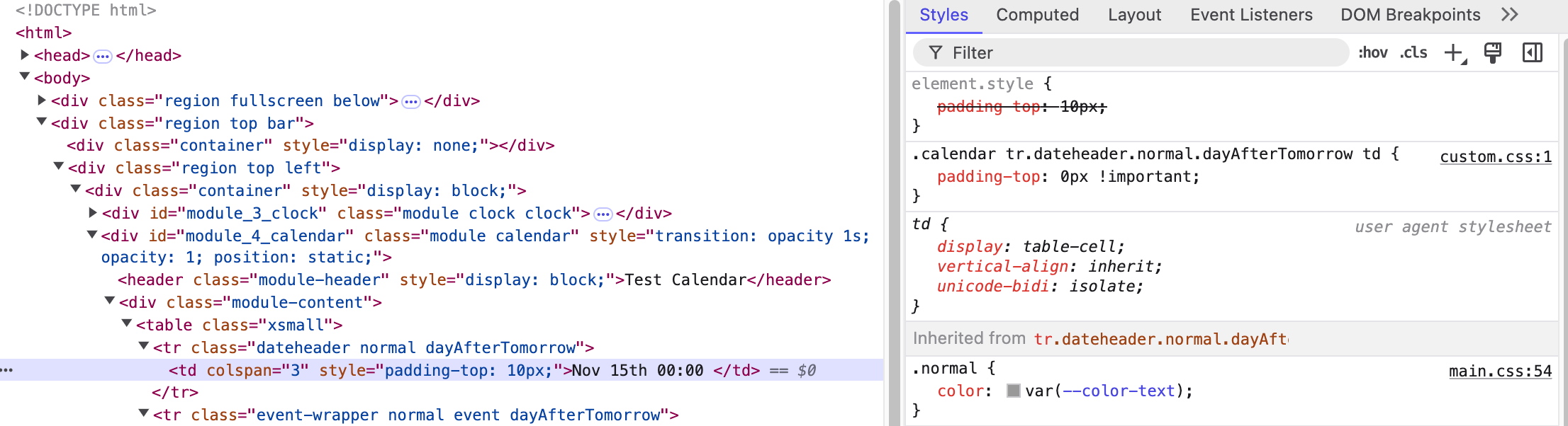

          @sdetweil said in Changing table cell in calendar module using custom.css:
          @evroom did you get this resolved?
          No, I did not and even with your additional tutorial I am hitting a black spot.
          I see this at the bottom:
          This corresponds with:
          <div class="module-content"
          ><table class="xsmall">
              <tr class="dateheader normal dayAfterTomorrow">
                  <td colspan="3" style="padding-top: 10px;">Nov 15th 00:00 </td>

                  sdetweil @evroom
                  @evroom can u see the custom.css styles selected in the right window on the dev window elements tab?
                  that will prove that the selector clause worked (or not)
                  evroomE 1 Reply Last reply Reply Quote 0
                  • evroomE Offline
                    evroom @sdetweil
                    Yes, I can:
                    But is stricken through.
                    So somebody high-jacked it probably.

                      sdetweil @evroom
                      @evroom
                      ok, the selector is good
                      that typing at the top has replaced it
                      but CSS selects the style that is MOST specific…
                      yours might not be vs the style ON the element
                      you can override by adding !important
                       .calendar tr.dateheader.normal.dayAfterTomorrow td {
                         padding-top: 0px !important;
                      • evroomE Offline
                        evroom @sdetweil
                        That did the trick !
                        I must say that the Elements tab is confusing, as it looks like the value did not change.
                        Probably this is the state before custom.css is applied.
                        The padding has gone (this was my goal):
