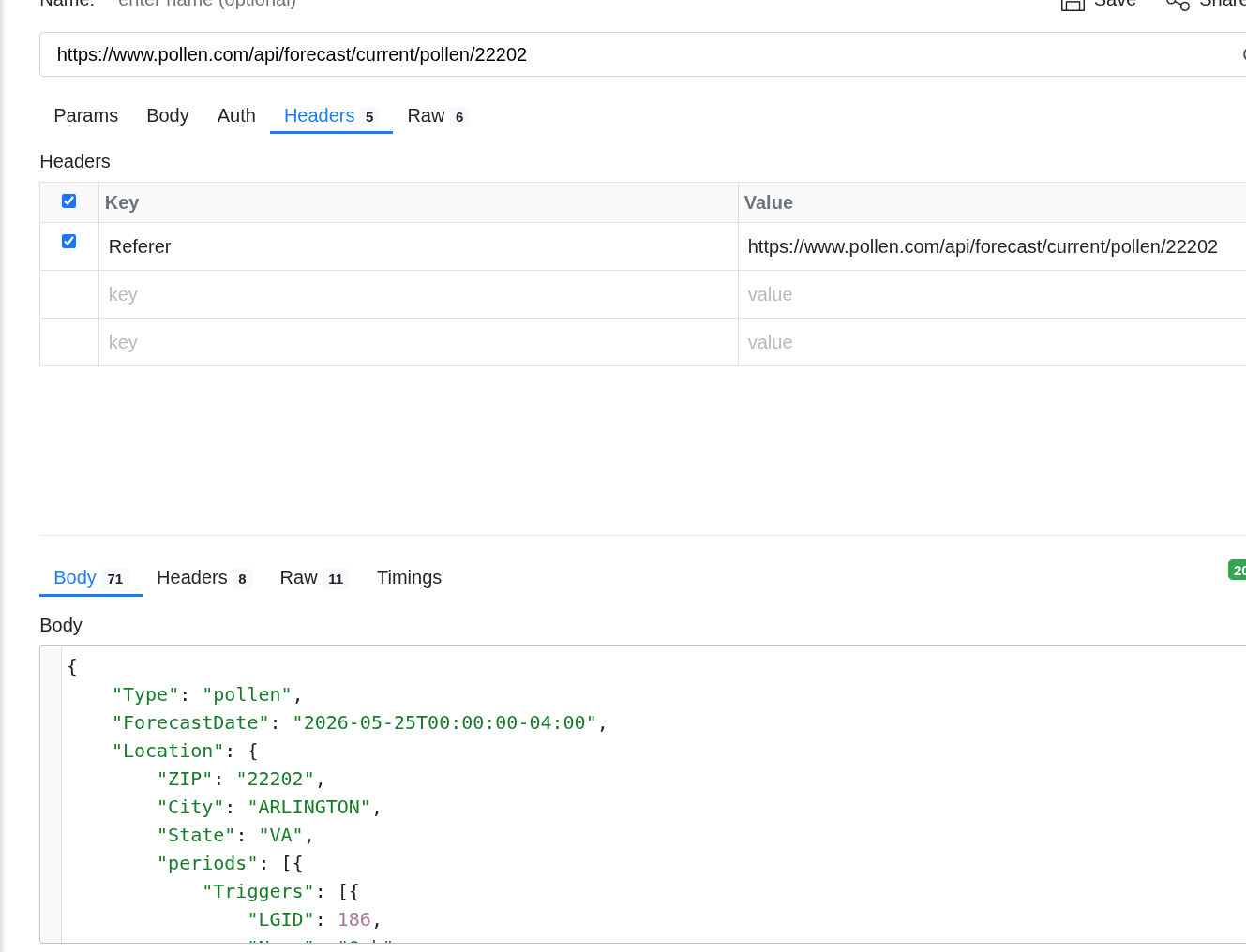

              @joey Hi how are things. Just from taking a quick look (am not the developer, don’t use this module, don’t have a test magicmirror to-hand) it looks like the API call the module’s making should work just fine.
              Trying to access the website using the url of the resource you can see inside MMM-Pollen.js doesn’t look like it will work, as I think maybe you need to specify a Referer in the header? Am new to this.
              If you want to test it out you could try: (this is what I did)
              • Go to an online API call utility like https://reqbin.com/
              • Add the base URL for the API call the module tries to make in the URL field (looks like it’s https://www.pollen.com/api/forecast/current/pollen/ )
              • Specify a zipcode for the call by adding it to the end of your URL so you have (e.g.) https://www.pollen.com/api/forecast/current/pollen/90210
              • Under Headers add a Key Referer and set its value to the same as the URL you have in the URL field
              • Click the Send button
              Mine came back with a json body that looks like it has pollen data in

                @raymondjspigot Hey, that is good stuff! I did not think about adding a Referer. Following your instructions, I was able to pull real data instead of getting an error:
                My config is using the example from the module, just with a different zipcode and different screen region:
