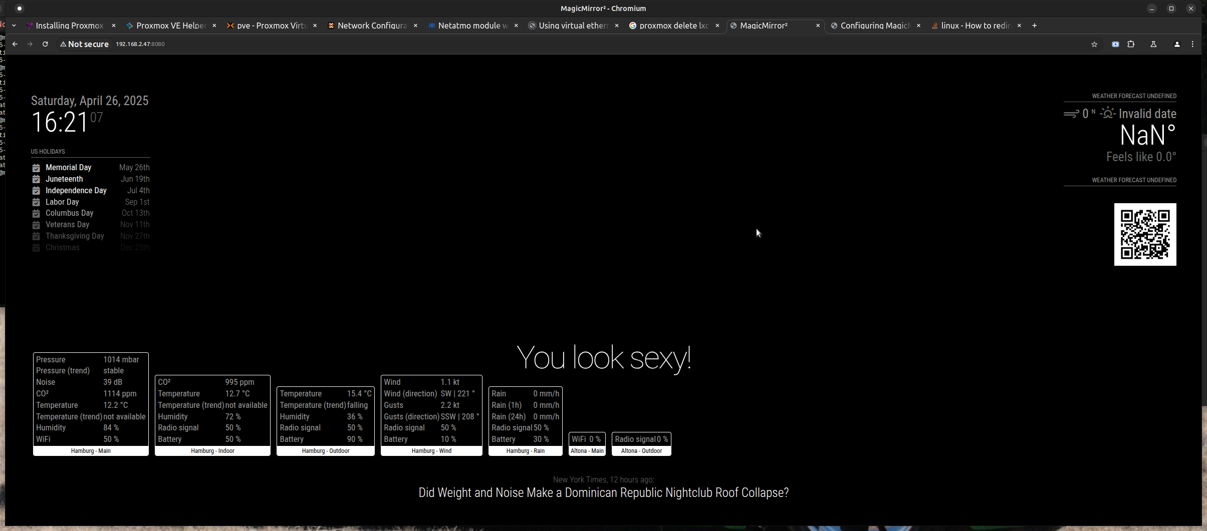

                        @kusselin problem here was disk and memory too small… 10g disk and 2048g memory and install finished…
                          @kusselin so I had to use the mockdata: true option as I don’t have any server for this
                          I set the clientid… to garbage numbers . module fails if not set
                          and mockdata: true and after a while I see this on the lxc container MM instance
                          (MMM-Config generated config entry)
                                  module: "netatmo",
                                  position: "bottom_left",
                                  order: "*",
                                  animateIn: "None",
                                  animateOut: "None",
                                     clientId: '1234567', // your app id
                                     clientSecret: '1212123', // your app secret
                                     refresh_token: '3223232', // your generated refresh token
                                    mockData: true
                                  disabled: false,
                                  hiddenOnStartup: false,
                                  configDeepMerge: false
                          the system service is setup without logging, so the MM app logging is lost…
                          for me lxc container looks and acts like a Virtual machine, (restricted to OS structure proxmox is running on)

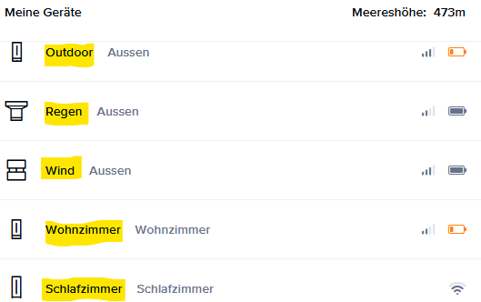

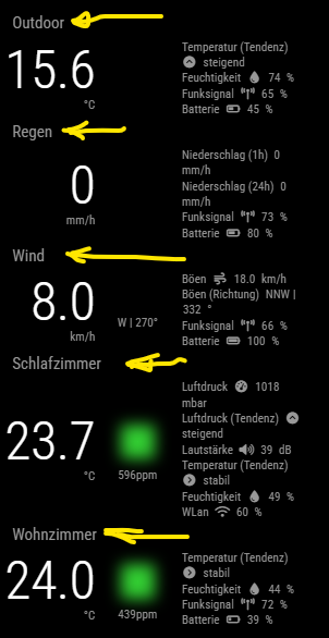

                                In your configuration, I’m missing the entry modulOrder. This entry was essential for me! I initially used the default name until I realized that it only works if the module name is stored exactly as you configured it in the web-app (https://auth.netatmo.com/de-de/access/login):
                                my config:
                                		module: 'netatmo',
                                		position: 'middle_center', // the location where the module should be displayed
                                			clientId: '*myID*', // your app id
                                			clientSecret: '*mysecret*', // your app secret
                                			refresh_token: *'mytoken*', // your generated refresh token
                                			moduleOrder: ["Outdoor","Regen","Wind","Schlafzimmer","Wohnzimmer"], //take same names from web-app!
                                    my config:
                                    		module: 'netatmo',

                                    Thanks s lot for your config…i changed it and now ist good and the netatmo Modul is running very well

                                          Hi sam, look here again…
                                          verbose cli /usr/bin/node /usr/bin/npm
                                          1 info using npm@10.9.2
                                          2 info using node@v22.15.0
                                          3 silly config load:file:/usr/lib/node_modules/npm/npmrc
                                          4 silly config load:file:/opt/magicmirror/.npmrc
                                          5 silly config load:file:/root/.npmrc
                                          6 silly config load:file:/usr/etc/npmrc
                                          7 verbose title npm run seerver
                                          8 verbose argv "run" "seerver"
                                          9 verbose logfile logs-max:10 dir:/root/.npm/_logs/2025-05-03T14_24_21_403Z-
                                          10 verbose logfile /root/.npm/_logs/2025-05-03T14_24_21_403Z-debug-0.log
                                          11 silly logfile start cleaning logs, removing 1 files
                                          12 silly logfile done cleaning log files
                                          13 verbose stack Error: Missing script: "seerver"
                                          13 verbose stack
                                          13 verbose stack Did you mean this?
                                          13 verbose stack   npm run server # run the "server" package script
                                          13 verbose stack
                                          13 verbose stack To see a list of scripts, run:
                                          13 verbose stack     at #run (/usr/lib/node_modules/npm/lib/commands/run-script.js:111:13)
                                          13 verbose stack     at async RunScript.exec (/usr/lib/node_modules/npm/lib/commands/run-script.js:40:7)
                                          13 verbose stack     at async Npm.exec (/usr/lib/node_modules/npm/lib/npm.js:207:9)
                                          13 verbose stack     at async module.exports (/usr/lib/node_modules/npm/lib/cli/entry.js:74:5)
                                          14 error Missing script: "seerver"
                                          14 error
                                          14 error Did you mean this?
                                          14 error   npm run server # run the "server" package script
                                          14 error
                                          14 error To see a list of scripts, run:
                                          14 error   npm run
                                          15 verbose cwd /opt/magicmirror
                                          16 verbose os Linux 6.8.12-8-pve
                                          17 verbose node v22.15.0
                                          18 verbose npm  v10.9.2
                                          19 verbose exit 1
                                          20 verbose code 1
                                          21 error A complete log of this run can be found in: /root/.npm/_logs/2025-05-03T14_24_21_403Z-debug-0.log
                                          and the latest Log:
                                          0 verbose cli /usr/bin/node /usr/bin/npm
                                          7 verbose title npm run server
                                          8 verbose argv "run" "server"
                                          9 verbose logfile logs-max:10 dir:/root/.npm/_logs/2025-05-03T14_24_50_844Z-
                                          10 verbose logfile /root/.npm/_logs/2025-05-03T14_24_50_844Z-debug-0.log
                                          13 verbose cwd /opt/magicmirror
                                          14 verbose os Linux 6.8.12-8-pve
                                          15 verbose node v22.15.0
                                          16 verbose npm  v10.9.2
                                          17 verbose exit 0
                                          18 info ok
                                          here is the info wenn i go into /opt/magicmirror/ and “npm run server”:
                                          The programs included with the Debian GNU/Linux system are free software;
                                          the exact distribution terms for each program are described in the
                                          individual files in /usr/share/doc/*/copyright.
                                          Debian GNU/Linux comes with ABSOLUTELY NO WARRANTY, to the extent
                                          permitted by applicable law.
                                          Last login: Sat May  3 16:23:40 2025 from 192.168.200.219
                                          MagicMirror LXC Container
                                              🌐   Provided by: community-scripts ORG | GitHub: https://github.com/community-scripts/ProxmoxVE
                                              🖥️   OS: Debian GNU/Linux - Version: 12
                                              🏠   Hostname: magicmirror-live
                                              💡   IP Address: 192.168.200.74
                                          root@magicmirror-live:~# cd /opt/magicmirror
                                          root@magicmirror-live:/opt/magicmirror# npm run server
                                          > magicmirror@2.31.0 server
                                          > node ./serveronly
                                          [2025-05-03 16:40:49.450] [LOG]   Starting MagicMirror: v2.31.0
                                          [2025-05-03 16:40:49.469] [LOG]   Loading config ...
                                          [2025-05-03 16:40:49.470] [LOG]   config template file not exists, no envsubst
                                          [2025-05-03 16:40:49.876] [INFO]  Checking config file /opt/magicmirror/config/config.js ...
                                          [2025-05-03 16:40:49.930] [INFO]  Your configuration file doesn't contain syntax errors :)
                                          [2025-05-03 16:40:49.931] [INFO]  Checking modules structure configuration ...
                                          [2025-05-03 16:40:50.003] [INFO]  Your modules structure configuration doesn't contain errors :)
                                          [2025-05-03 16:40:50.519] [LOG]   Loading module helpers ...
                                          [2025-05-03 16:40:50.528] [LOG]   No helper found for module: alert.
                                          [2025-05-03 16:40:50.551] [LOG]   Initializing new module helper ...
                                          [2025-05-03 16:40:50.555] [LOG]   Module helper loaded: updatenotification
                                          [2025-05-03 16:40:50.557] [LOG]   No helper found for module: clock.
                                          [2025-05-03 16:40:50.934] [LOG]   Initializing new module helper ...
                                          [2025-05-03 16:40:50.936] [LOG]   Module helper loaded: calendar
                                          [2025-05-03 16:40:50.941] [LOG]   No helper found for module: compliments.
                                          [2025-05-03 16:40:50.943] [LOG]   No helper found for module: MMM-OpenmapWeather.
                                          [2025-05-03 16:40:50.950] [LOG]   Initializing new module helper ...
                                          [2025-05-03 16:40:50.952] [LOG]   Module helper loaded: netatmo
                                          [2025-05-03 16:40:50.954] [WARN]  No /opt/magicmirror/modules/MMM-OpenWeatherForecast/MMM-OpenWeatherForecast.js found for module: MMM-OpenWeatherForecast.
                                          [2025-05-03 16:40:50.955] [LOG]   No helper found for module: MMM-OpenWeatherForecast.
                                          [2025-05-03 16:40:50.955] [LOG]   No helper found for module: MMM-Blitzer.
                                          [2025-05-03 16:40:50.958] [LOG]   Initializing new module helper ...
                                          [2025-05-03 16:40:50.960] [LOG]   Module helper loaded: MMM-ApothekenNotdienst
                                          [2025-05-03 16:40:50.962] [LOG]   Initializing new module helper ...
                                          [2025-05-03 16:40:50.965] [LOG]   Module helper loaded: MMM-ioBroker
                                          [2025-05-03 16:40:50.965] [LOG]   No helper found for module: MMM-Carousel.
                                          [2025-05-03 16:40:51.040] [LOG]   Initializing new module helper ...
                                          [2025-05-03 16:40:51.040] [LOG]   Module helper loaded: MMM-PublicTransportHafas
                                          [2025-05-03 16:40:51.480] [LOG]   Initializing new module helper ...
                                          [2025-05-03 16:40:51.480] [LOG]   Module helper loaded: MMM-RNV
                                          [2025-05-03 16:40:51.482] [LOG]   Initializing new module helper ...
                                          [2025-05-03 16:40:51.482] [LOG]   Check MagicMirror² version for node helper 'MMM-Fuel' - Minimum version: 2.15.0 - Current version: 2.31.0
                                          [2025-05-03 16:40:51.482] [LOG]   Version is ok!
                                          [2025-05-03 16:40:51.483] [LOG]   Module helper loaded: MMM-Fuel
                                          [2025-05-03 16:40:51.591] [LOG]   Initializing new module helper ...
                                          [2025-05-03 16:40:51.591] [LOG]   Module helper loaded: MMM-Remote-Control
                                          [2025-05-03 16:40:51.658] [LOG]   Initializing new module helper ...
                                          [2025-05-03 16:40:51.659] [LOG]   Module helper loaded: newsfeed
                                          [2025-05-03 16:40:51.659] [LOG]   All module helpers loaded.
                                          [2025-05-03 16:40:51.663] [LOG]   Starting server on port 8080 ...
                                          [2025-05-03 16:40:51.664] [WARN]  You're using a full whitelist configuration to allow for all IPs
                                          [2025-05-03 16:40:51.673] [ERROR] Whoops! There was an uncaught exception...
                                          [2025-05-03 16:40:51.673] [ERROR] Error: listen EADDRINUSE: address already in use 0.0.0.0:8080
                                              at Server.setupListenHandle [as _listen2] (node:net:1939:16)
                                              at listenInCluster (node:net:1996:12)
                                              at node:net:2205:7
                                              at process.processTicksAndRejections (node:internal/process/task_queues:90:21) {
                                            code: 'EADDRINUSE',
                                            errno: -98,
                                            syscall: 'listen',
                                            address: '0.0.0.0',
                                            port: 8080
                                          [2025-05-03 16:40:51.673] [ERROR] MagicMirror² will not quit, but it might be a good idea to check why this happened. Maybe no internet connection?
                                          [2025-05-03 16:40:51.673] [ERROR] If you think this really is an issue, please open an issue on GitHub: https://github.com/MagicMirrorOrg/MagicMirror/issues
                                          [2025-05-03 16:40:51.783] [INFO]  System information:
                                          ### SYSTEM:   manufacturer: ; model: ; virtual: false
                                          ### OS:       platform: linux; distro: Debian GNU/Linux; release: 12; arch: x64; kernel: 6.8.12-8-pve
                                          ### VERSIONS: electron: undefined; used node: 22.15.0; installed node: 22.15.0; npm: 10.9.2; pm2: 5.4.3
                                          ### OTHER:    timeZone: Europe/Berlin; ELECTRON_ENABLE_GPU: undefined
                                          her my Config from MM:
                                          /*************** AUTO GENERATED BY REMOTE CONTROL MODULE ***************/
                                                module: 'netatmo',
                                                position: 'bottom_left',
                                                  clientId: '123456,
                                                  clientSecret: '1234',
                                                  refresh_token: '1234',
                                                  moduleOrder: [
                                                    'Aussenmodul',
                                                    'Regenmesser',
                                                    'Windmesser',
                                                    'Wohnen'
                                                  updateInterval: 6,
                                                  design: 'bubbles',
                                                  horizontal: false,
                                                  showStationName: false,
                                                  showModuleNameOnTop: true,
                                                  fontClassModuleName: 'small'
                                          what I don’t understand either…because of the remote control module the config looks completely different than normal…but I think that has nothing to do with Netatmo…right?
                                          I would be really grateful for your help…
                                          Greetings
                                            sdetweil @kusselin
                                            @kusselin the ‘already in use’ is because the container is running MagicMirror as a system service
                                            you could use a different port for the test
                                            export MM_PORT=8090
                                            npm run server
                                            now you have two instances running
                                            one on 8080 and one on 8090
                                            ctrl-c to stop the one on 8090
