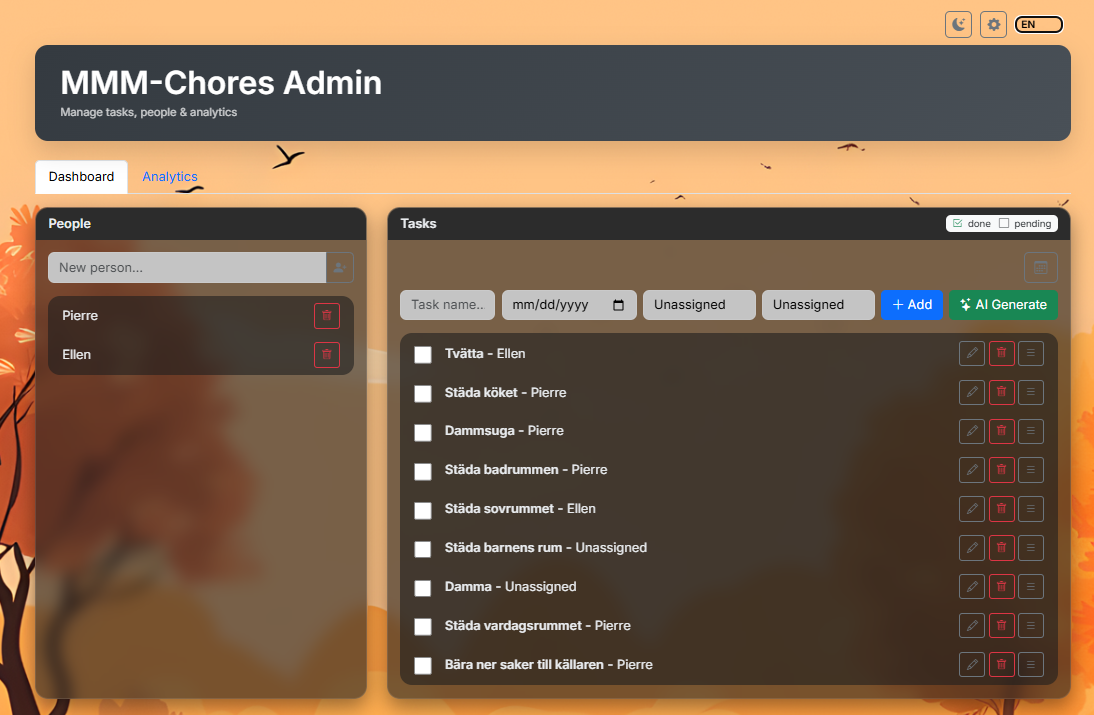

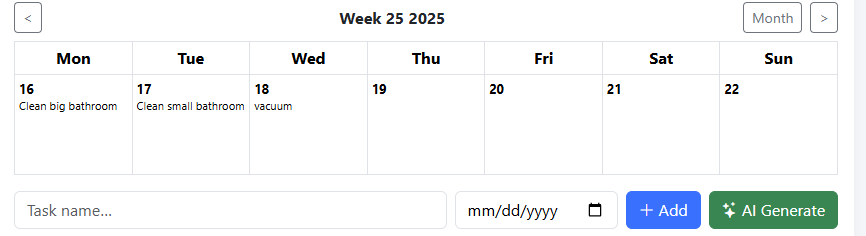

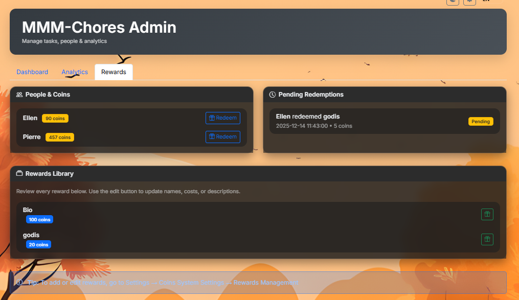

          • PierreGodeP
            PierreGode Module Developer
            Major update on its way coming days!
            • added optional login with possibility to add both write permission user and read only user.
            • added pushover notification possibility+ configuration to set daily reminders at specific time.
            • added background images " 4 seasons"
              -reworked task list, moved up user assignment to creation space
              -reworked edit option to be a form to be able to update task description, user and date
            see images below

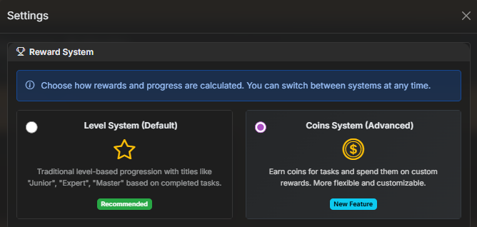

              • PierreGodeP
                @johngalt @sdetweil @redbeardedninja @sarote @mischag @plainbroke @
                New big update out now.
                New reward system
                more recurring options
                Fixes and updates.
                Reply Quote 1

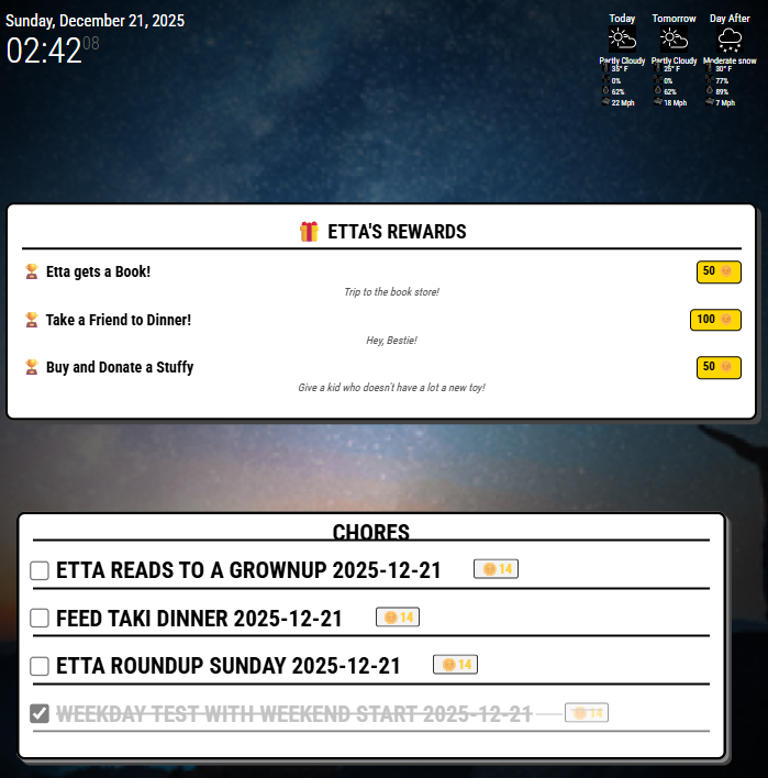

                • E
                  ewingfox
                  Hello! New user here, love the UI (especially the admin features!) I’m building a secret Christmas gift for my wife (who is obsessed with organization). I was about to give up on MM - until I found your module!
                  Question: I see daily, weekly, monthly options - is there a feature to set reoccurring events that are Monday Friday? This is specific to kids who may have daily ‘weekday’ tasks to do that aren’t required on Saturday or Sunday. I’m happy to skip the UI - aka, create an event in the UI and then tweak the underlying config via CLI.
                  Thank you!!!

                      • E
                        ewingfox @ewingfox
                        I’ve done a lot of testing and submitted PR-220 . It turns out there are some really complicated date functions that worked—unless they didn’t (edge cases with creating a weekday only task, setting start date on a Weekend, etc).
                        else if (recurring === "daily-weekdays") {
                            // We ignore the d.setDate(+1) and just find the next valid weekday from today
                            let testDate = new Date();
                            testDate.setDate(testDate.getDate() + 1);
                            while (testDate.getDay() === 0 || testDate.getDay() === 6) {
                            // Force 'd' to be this specific date, bypassing module interference
                            d.setTime(testDate.getTime());
                          } else if (recurring === "daily-weekends") {
                            while (testDate.getDay() >= 1 && testDate.getDay() <= 5) {
                        The logic is working (finally)- I wish I was better at this stuff, I’m a DevOps guy, so I’m lazy and not particularly talented at coding unless I can break thousands of servers with automation (then I’m a pro lol).
                        I also went through and added the requisite language support for the 10 supported languages for the two new elements included in admin.html
                                              <div class="col-sm-auto">
                                                <select id="taskRecurring" class="form-select">
                                                  <option value="">One time</option>
                                                  <option value="daily">Daily</option>
                                                  <option value="weekly">Weekly</option>
                                                  <option value="daily-weekdays">Daily (Weekdays Only)</option>
                                                  <option value="daily-weekends">Daily (Weekends Only)</option>
                                                  <option value="monthly">Monthly</option>
                                                  <option value="yearly">Yearly</option>
                                                  <option value="every_X_days_2">Every 2 Days</option>
                                                  <option value="every_X_days_3">Every 3 Days</option>
                                                  <option value="every_X_weeks_2">Every 2 Weeks</option>
                                                  <option value="every_X_weeks_3">Every 3 Weeks</option>
                                                  <option value="first_monday_month">First Monday of Month</option>
                                                </select>
                                              </div>
                        I’m testing a few .css changes to improve touchscreen support - you can see plenty of other .css issues I’ll nave to sort out, sreenshots from chrome of the MM page shows it’s not adjusting well to different browsers…
                        I also put together a mini-module to provide a placard showing the options in the ‘reward store’ - My kid is super goal oriented, so being able to take advantage of @pierregode 's awesome reward system is going to be a big win!
                        I’m going to look further into making this interactive and set up some kind of email to us to indicate she’s redeemed her coins on a particular reward.
                        The current MMM-ChoreRewards is super crude and rude - you can see plenty of other .css issues I’ll have to sort out. @sdetweil hopefully I’ve formatted this post better - thank you for the #mod help!
                        htilburgsH 1 Reply Last reply

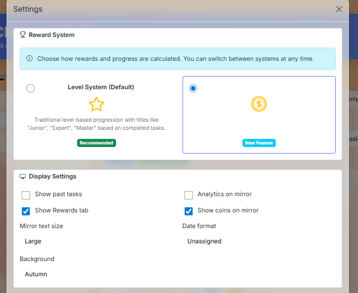

                          @pierregode

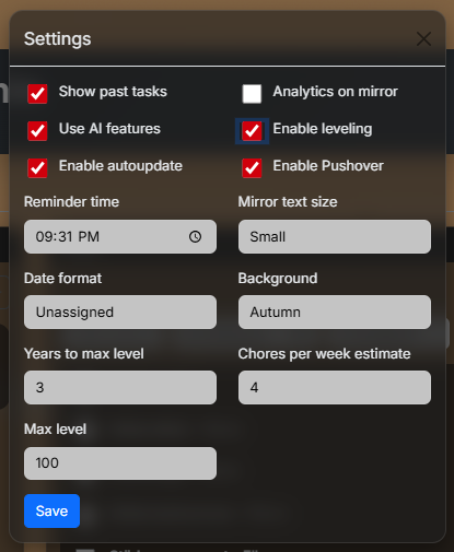

                          I’m using dateFormatting: “” in my config, but I stil got the date on the dashboard. Do I somethine wrong?
                                            module: "MMM-Chores",
                                            header: "Takenlijst",
                                                  updateInterval: 60 * 1000,
                                                  adminPort: 5003,
                                                  showDays: 365,
                                                  showPast: true,
                                                  dateFormatting: "",
                          (still trying to learn JS, but not afraid to ask and AI is my best friend) ☺
                          S PierreGodeP 2 Replies Last reply
                            sdetweil @htilburgs
                            @htilburgs try
                            dateFormatting:null
                            • PierreGodeP
                              PierreGode Module Developer @htilburgs
                              @htilburgs
                              You can set it in the web in config page > Display Settings > Date format > Unassigned > Save
                              htilburgsH 2 Replies Last reply
                              Reply Quote 1
                              • htilburgsH
                                htilburgs @PierreGode
                                @PierreGode said in MMM-Chores - Manage and keep track of your household Chores:
                                @htilburgs
                                I’m sorry for this late reaction. I’ll try this tomorrow (monday) when I have access to my mirror. Currently not at home. I let you Guys know the results.
                                Reply Quote 1
                                • htilburgsH
                                  @PierreGode
                                  Tested and works. Thanks!

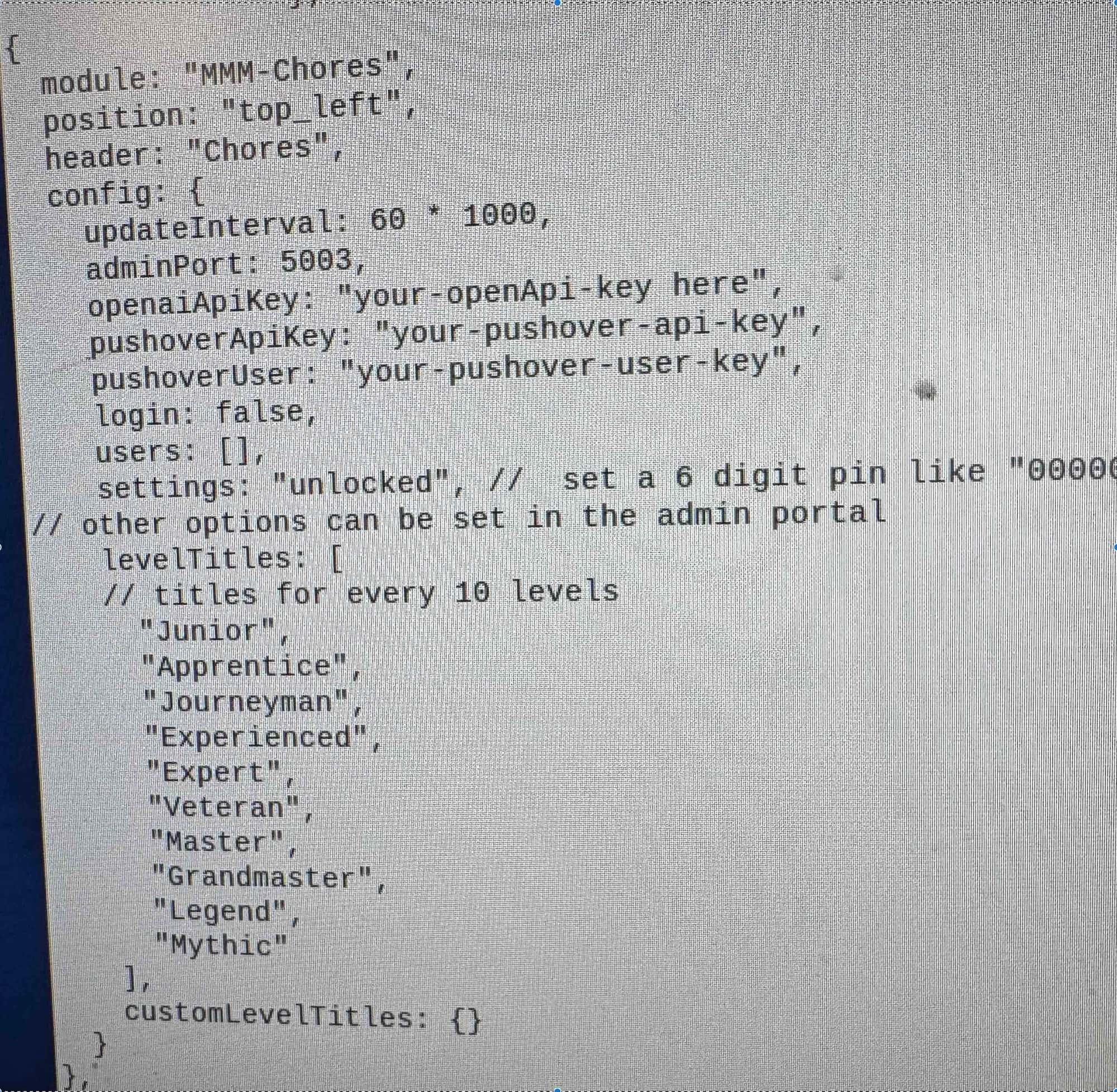

                                  • J
                                    jtillinghast
                                    Hey all-- I’m trying to get MMM-Chores working, but no matter what I do, the module shows up in the mirror as “No tasks to show (emoji).” I have populated the list with tasks, and confirmed that they appear in the data.json file. And I can reach the admin panel for Chores, so I know the server is running. Relevant codeblock from config.js:
                                    					position: "bottom_left",
                                    					classes: "overview",
                                    					header: "Chores",
                                    						adminPort: 5003,
                                        					settings: "unlocked",
                                    						dateFormatting: "",
                                    						login: false,
                                    						users: [{ username: "dad", password: "", permission: "read" }],
                                    I’m sure it’s something simple, so I appreciate your help! TIA.
                                    PierreGodeP 1 Reply Last reply
                                    • PierreGodeP
                                      PierreGode Module Developer @jtillinghast
                                      @jtillinghast
                                      What does the command pm2 logs give you?
                                      J 1 Reply Last reply
                                      • J
                                        jtillinghast @PierreGode
                                        @PierreGode And of course, today it works for seemingly no other reason. I don’t believe I have touched anything in the module or the config since it wasn’t working, but now it looks good! I will continue to monitor. Thanks.
                                        Reply Quote 1
