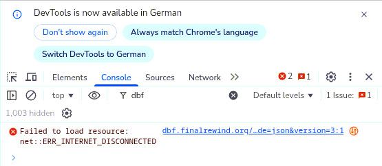

                sdetweil @sletrabf
                @sletrabf open the developers window
                ctrl-shift-i
                select the console tab
                enter a unique part of the module name in the filter field, dbf
                and see what you see

                  It didn’t take long until I have gotten the same error - at some point, the table doesn’t get reloaded. I logged in remotely and pressed CTRL + SHIFT + I. Apparently, the server could not be reached and the script cannot handle that.
                  Unfortunately, I was not able to see any other of the debug messages that were issued before (maybe they were deleted because a long time has elapsed). I’ll try to read the error closer after it occurs.

                    sdetweil @sletrabf
                    @sletrabf error recovery is always a challenge.
                    You could access the MagicMirror server from another browser anywhere , just change the address and IpWhitelist config options. Interesting in the module fails there too

                        sdetweil @sletrabf
                        @sletrabf this module runs completely in browser
                        So two clients will operate independently wherever they are.
